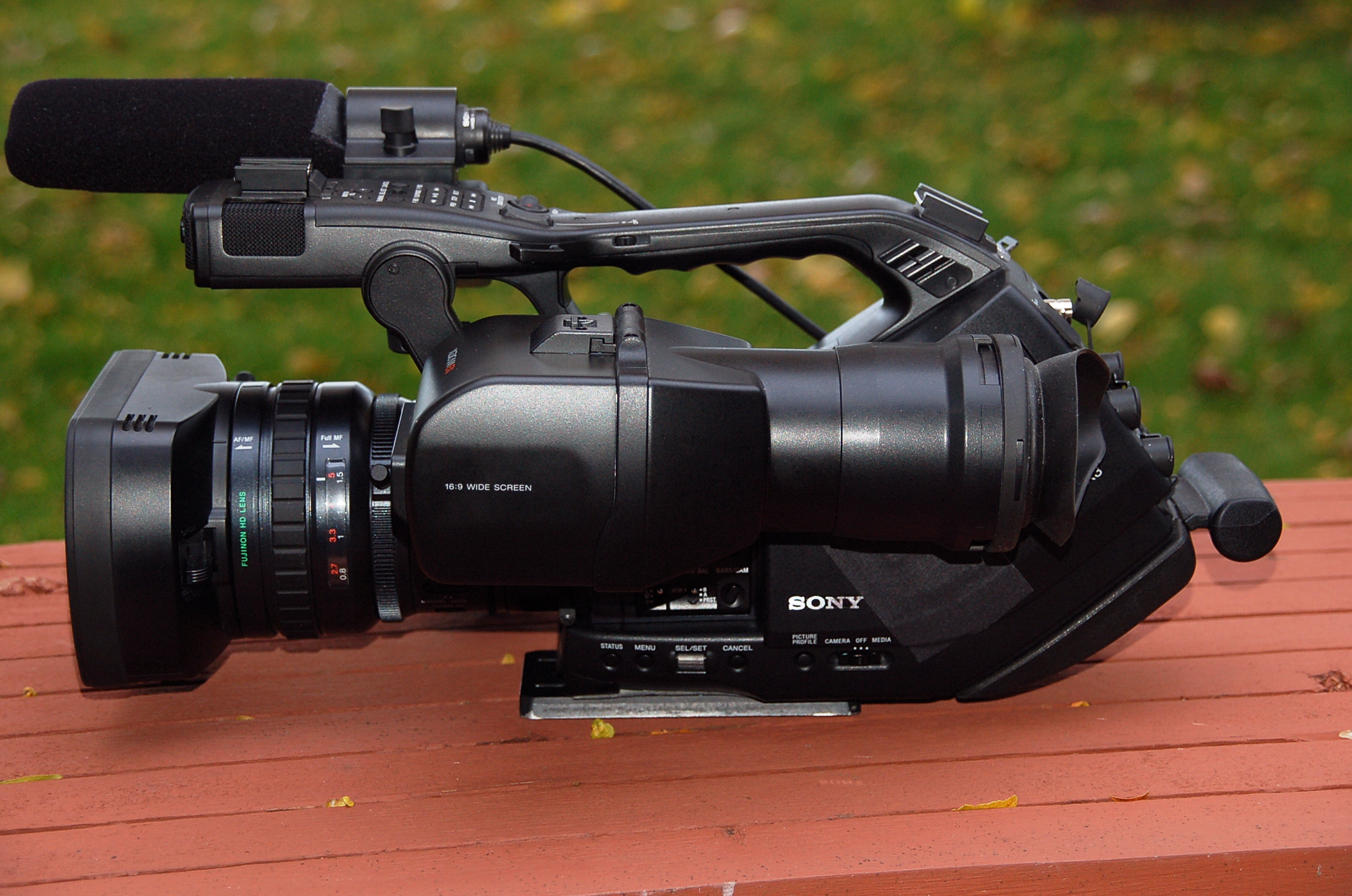

Do you like my camera?

Ok, I'll bite. Did you break the viewfinder arm, or rebuild it?

you noticed!
Rebuild would be an overstatement, call it a modification

how did you drop it down so much?

..I want to know how ..... please...

It also begs the question, why?

And what's with the black tape over the card slot door?

taping the card slot door is one of my favourite tricks, keeps the dust out when shooting in very dusty environments.
remember to exercise caution when removing that tape though, you might remove more than you bargained for....

"what's with the black tape over the card slot door?"
simple
keeps dust and dirt out.
I backed the tape with another piece of tape in the middle to keep it from sticking to the door. So the tape only sticks to the body around the door to seal out dust and dirt.
Remove the lens. Cap the lens port. Flip the camera upside down. Remove the plastic hatch (4 screws and 2 tabs) under the internal microphone.
You will now have access to the rod that the viewfinder is attached to.
There is a silver metal cam on that rod. It has 2 stops to restrict the rotation. I looked at this and saw plenty of extra wire to allow further rotation so I cut off the one stop on the cam with a dremel tool and small cutoff wheel. I taped over everything to control the dust from cutting. Didn't take much cutting to remove that tab.
Only problem I ran into was putting the hatch back on. It has 2 plastic tabs that were difficult to bend back into their slots.
There is plenty of wire to allow for this extra rotation.
Storage. I want to put this camera in a backpack. The viewfinder sticking up takes more room and can also get damaged that way. When packing away, I'll also remove the mic holder.
Also, I shoot inside car interiors and every bit of clearance helps.

That is bloody brilliant. 2 questions. Why has Sony put in that extra stop? Why don't I have the courage to try for myself? Your ex3 looks like a sleek packable beast.
