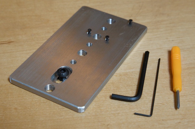

I have made a number of these stronger EX1 bottom plates, and people like them.
I have also replaced broken Sony plates.
If you are interested contact me. And I will send you more info.

Two advantages to this plate:
1) The plate is a solid piece of metal that is better attached to the camera than the plate Sony provides. This is achieved by having more screws into the camera chassis.
2) This plate can be attached to the tripod release plate using two screws a large distance apart.
Combined these two features will dramatically reduce the possible range of movement between the camera body and the tripod head compared to a screw and a pin.The other not insignificant advantage is preventing the original plate from being ripped out of the camera.
As the plate is made of aluminium the extra weight will be quite small.
Only thing I'd like is for these plates to be black anodized. I'd also be happier if the threaded holes had stainless inserts but that's likely to add considerably to the cost.

The price is $125.00 plus shipping. They are shipping now USPS, UPS or FEDEX.
Thank you for the input, Bob.
I am looking into having plates anodized or powder coated.
I may set up anodizing myself, and there is a shop here in town that does powder coating.
I will find out how much this will add to the price and I will order stainless inserts if a lot of users would prefer that. I should be able to get those in a few days.
I will post added cost here as soon as I have info.
Contact me if you want more info.

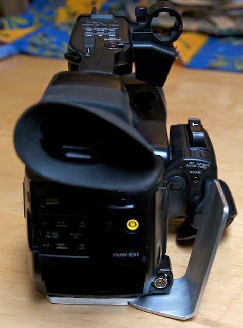

Looks good Olof. I have been using a similar home made plate and it does make the EX1 much more stable by using the extra screws at the rear of the camera body. The additional plate on the right side would work well as a mount for the Nanoflash. How much with the plate?

The cost with a side plate is $150.00
I can drill and tap side plate to your specs. Or I can make a hotshoe mount on it.

Olof - how do you envision the Nano being attached to this plate? on the outer side away from the camera or is there room between the plate and the camera body. I may be interested in this if it could fit closer to the camera body or somehow be mounted in between the body and the plate.

I can make the plate to any spec. The original "wing" was meant to hold the mic receiver on the inside using velcro.
I have ordered a EX1r myself and I will be getting the Nano for it.
I would be happy to make a "wing" specifically for the Nano. If you send me specs or photos with measurements, I would be very happy to make you a wing for it. And I would guarantee the fit.

Olaf, are you selling just the bottom plate or the entire assembly shown in the right-most picture that are mounted on the EX1?

You can order just the plate or plate with "wing", I like the word wing, I used to call it side plate. Matt Daviss on this forum started calling it a wing.
I can customize the wing to what you need.
I made one for myself initially for my EX3 to mount a pair of Sony wireless mic receivers. If you send me specs I will customize wing to your needs.
