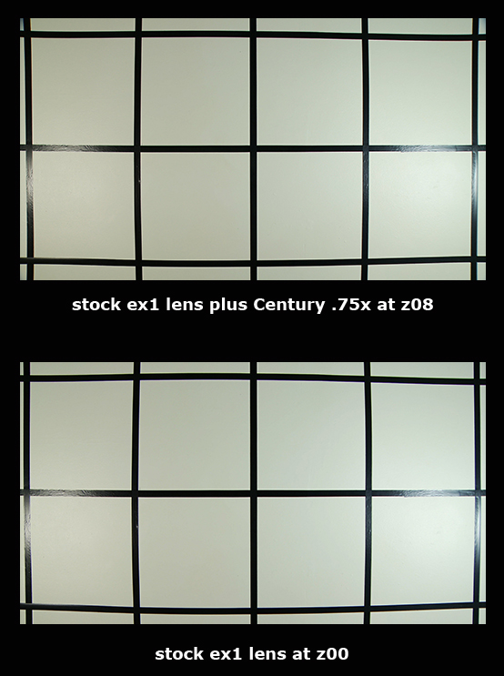

Andrew, I agree with your observations and I also think this is what Century/Schneider is selling today. As you say, the barrel distortion goes away in the z07-z11 range, but then you have to ask yourself why are are even bothering with the wide lens, since a setting of z08 with the adaptor is the same as full wide without the adaptor. See the image which I posted in that other thread: http://www.dvinfo.net/forum/attachme...ns-compare.jpg
The vignetting is frustrating because you can't just zoom in a little to make it disappear. It actually gets worse in the z10-z15 range.
Having said all of this, your subject matter will have a big effect on this. The vignetting is not always noticeable, it depends on the composition and lighting of the shot. To be fair, the EX1 (don't know about the EX3) lens has a significant amount of barrel distortion all by itself, so I think a good deal of the problem in that area may be a garbage-in-garbage-out sort of scenario...
