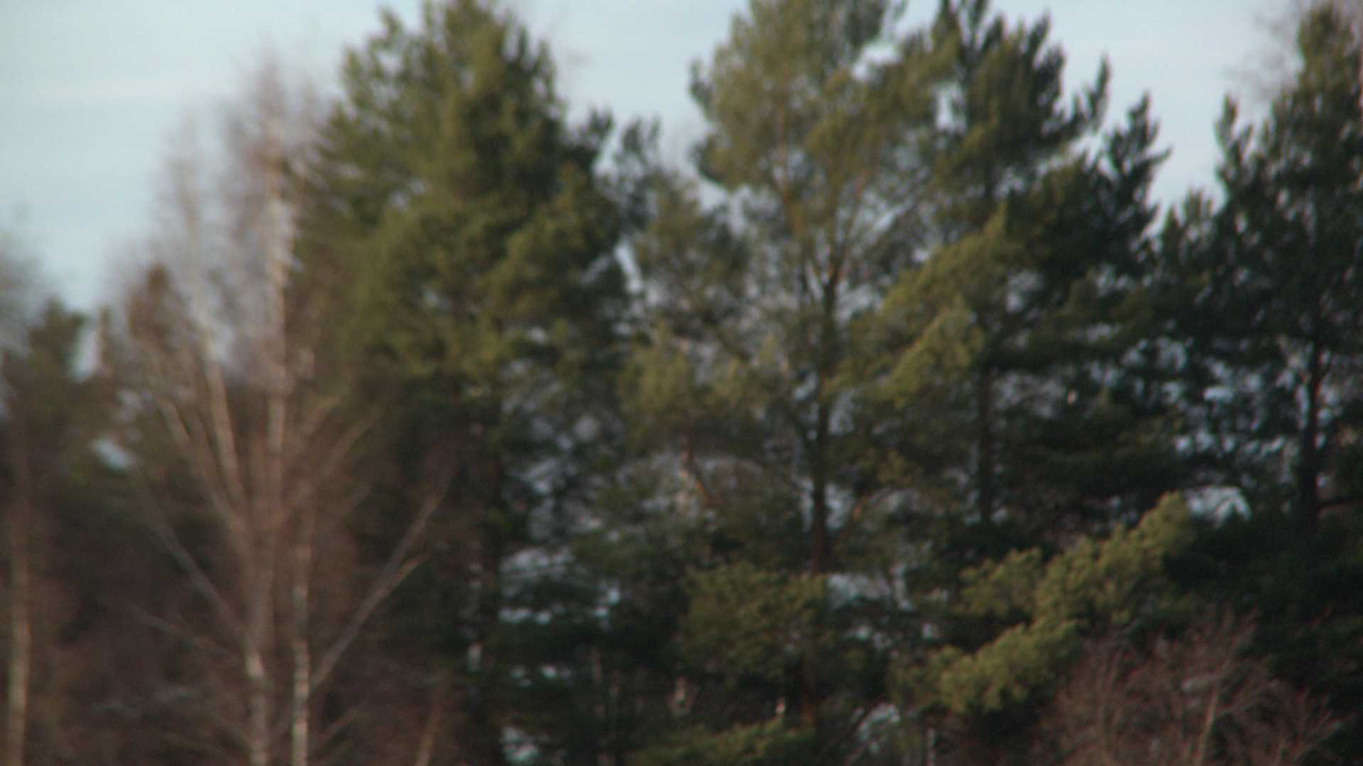

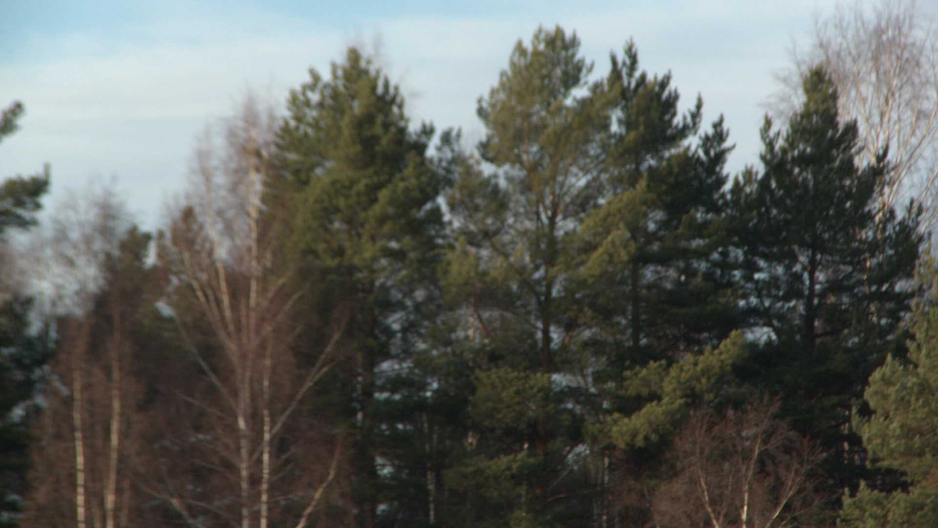

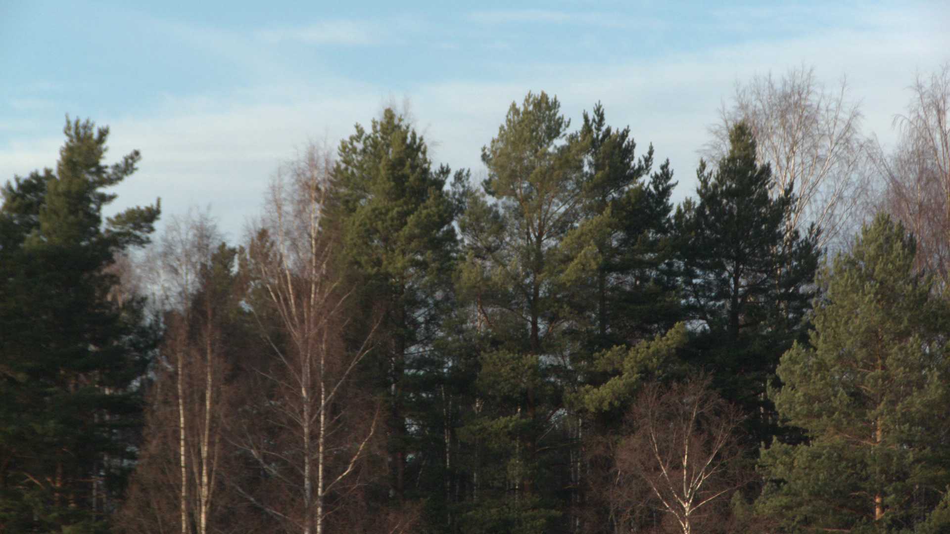

Today I noticed that focusing at infinity does not work. With telephoto at Z99 it goes blurry, with zoom at Z80 it is almost normal. But at Z80 the left side seems to be worse off than the right side.
It seems strange that the lens goes bad without any apparent reason after almost two years.
I will send it for service, but I am worried about the two year warranty - are there some cases of Sony refusing to the repair of this type of fault?

A buddy of mine who was using one of my EX1s noticed this problem as well. He couldn't focus on infinity even on stuff miles away like Pikes Peak in Colorado Springs.
I thought I was going to have to send the 'out of warranty' camera in to get a new lens.
Just to make sure, I told him about the back focus maintenance menu, so he tried the back focus adjustment (you can find out how to do this in this forum), nothing changed. He did it an additional 2 times, it fixed it.
Now the camera focuses on infinity. No more problems.
