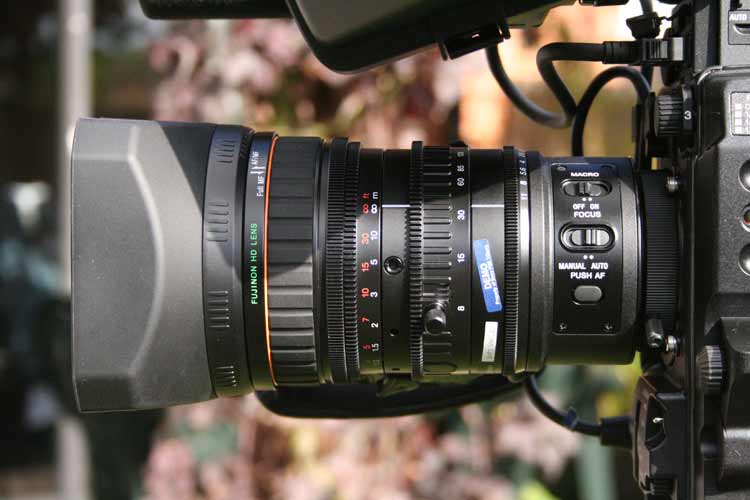

You should be able to use a standard Fujinon remote focus on the 350K lens. The focus ring has two raised gear rings around it with 2 different pitches as well as the threaded screw holes for attaching the gear block. So it looks like a standard remote focus will fit. I did not test this but it's certainly going to be a lot simpler than with the EX1/EX3. The remote zoom connector is the standard 8 pin threaded hirose as found on most Fujinon Pro lenses. I've attached a close up photo of the lens.
