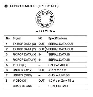

Thanks Ted, I have a contact who can probably make up an adapter but he/I need a wiring diagram of the EX3 zoom connector and a 8 pin plug to suit! I can order the Jonijib adapter but it's $100 US just for freight so 180.00 US!...which is ridiculous!
I have a few perfectly good, pro zoom controllers and simply need an adapter! And yes, a dealer for Libec here in Australia told me they won't sell their adapter part separately so i'm stuffed there too!
Any one with a diagram?

Old November 10th, 2008, 02:46 AM   #7
Join Date: Nov 2007
Location: Agua Blanca Ibiza
Posts: 305
This is all I have right now.
Paul
Hey Paul, thanks for that! Should help if I can source a 8 pin plug to suit the EX3.
