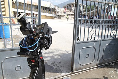

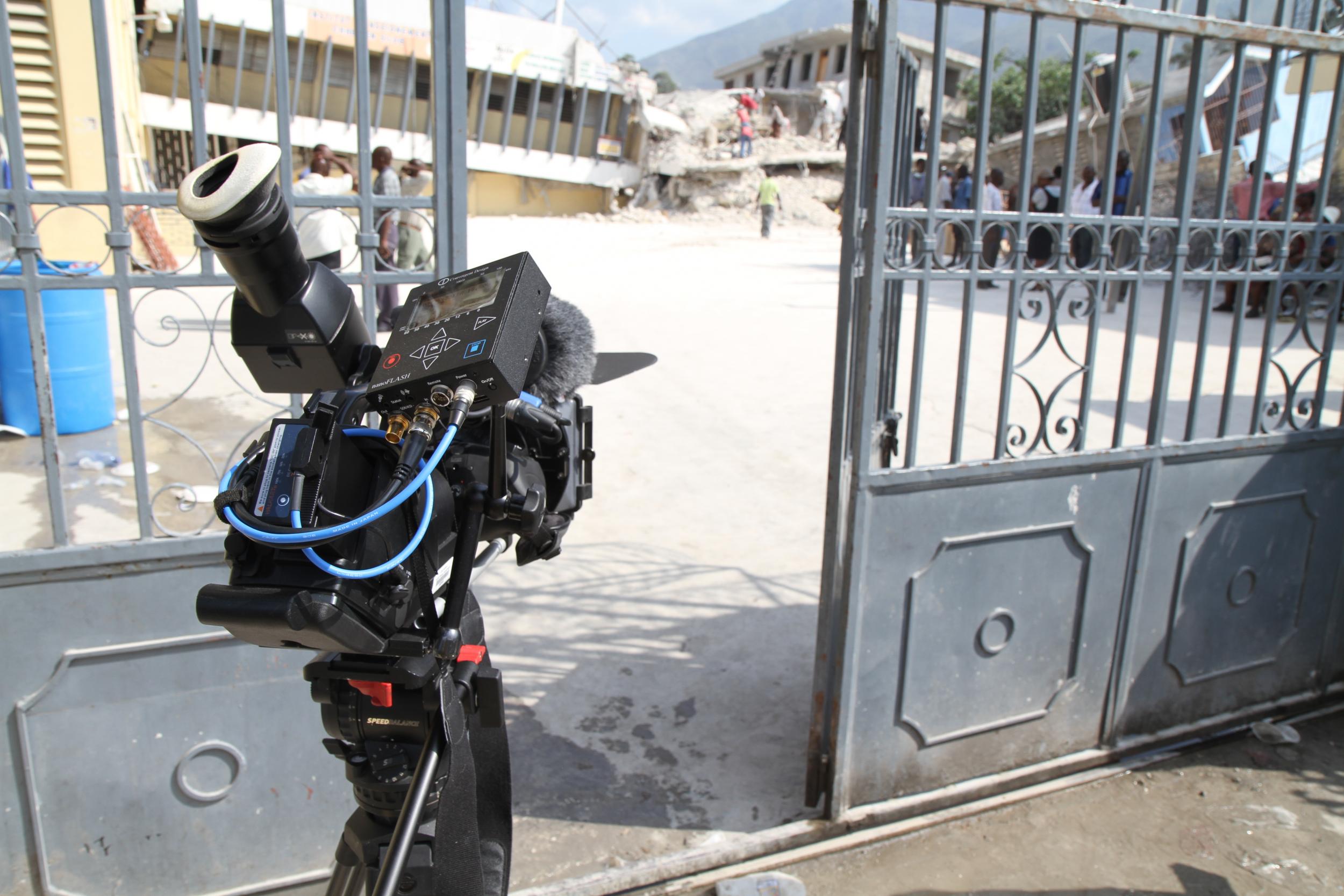

Craig,
I shoot ENG style with our EX-3 on a regular basis. The camera isn't perfect but it does so many things well I have learned to work with a few quirks. I have a Fujinon zoom controller that is on my tripod frequently, but when I'm on/off the tripod a lot it tends to stay off. Shot steadiness is really a function of your tripod. A Sachtler FSB 6 works just fine for me when I travel.

Dave, is that a hard drive recorder attached to your camera? Which Fujinon controller do you use? I have an 8 pin Fujinon my DSR130 that I wouldn't mind using.

Craig,
the recorder is called a Nanoflash. It's mounted to the base plate of my camera on an Israeli arm. the Fujinon controller was given to me by one of our Engineers. I'm sorry I don't know the number but it works with all Fujinon broadcast lenses. (might be an SRD-92B)
