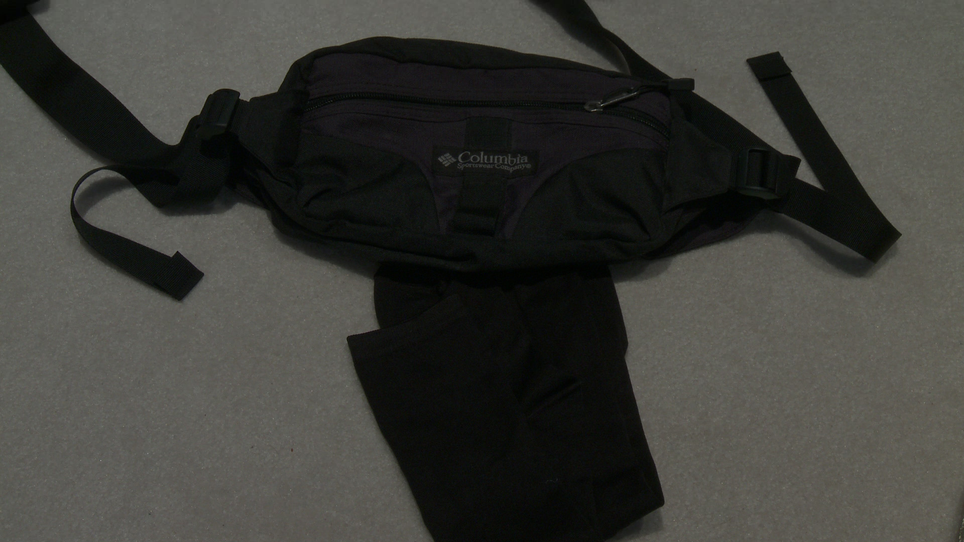

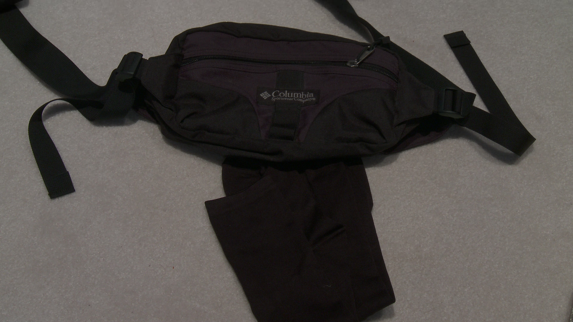

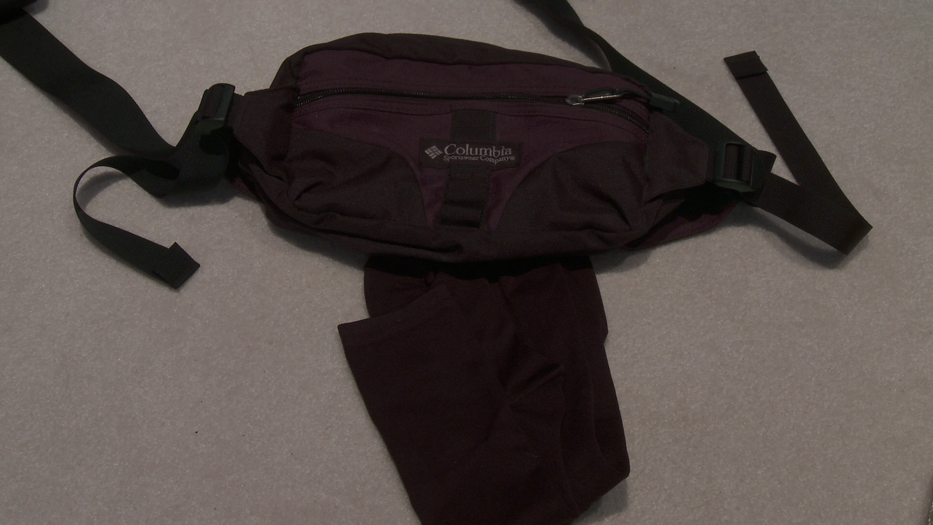

I recently received my Schneider Optics Platinum IR 1/2 filter and did a quick test to compare it against the B+W 486 and Tiffen T1 filters that I had purchased to try to address the IR "contamination" resulting in the red tinge to PMW-EX1 footage. There's nothing new here to report that others haven't already done so with the other filters, but I thought it would be informative to share some images I took with each of the filters on the camera for the same setup for comparison.
The lighting used was a Halogen flood that the PMW-EX1 white balanced to 3000k native with no filters. The socks and pack are black (though the pack has a mix of material as evident in the images).
The attached still images were pulled from footage with Clip Browser. The PMW-EX1 was manually re-white balanced for each shot, 0db gain was used for all, and the Zoom position was 23 (more wide than tele).
The 6 still images are: (the initial numbers used for the file names are only for numbering purposes and have no other meaning)
- 08 No filter (native) at f5.6 (PMW-EX1 reported 3000k WB)
- 09 B+W 486 filter at f5.6 (PMW-EX1 reported 3000k WB)
- 11 Tiffen T1 filter at f5.6 (PMW-EX1 reported 3100k WB)
- 12 Tiffen T1 filter at f4.8 (PMW-EX1 reported 3100k WB)
- 14 Schneider Optics Platinum IR 1/2 stop filter at f5.6 (PMW-EX1 reported 3200k WB)
- 15 Schneider Optics Platinum IR 1/2 stop filter at f4.8 (PMW-EX1 reported 3200k WB)
My thoughts:
- the IR issue is very clear in the native PMW-EX1 image with no filter
- the B+W 486 shows no light loss, but does seem to have a color cast towards the edges
- the T1 shows a stop of light loss, has a blue color cast throughout the image, but does seem to show the blackest blacks
- the Platinum IR shows about a 1/2 stop loss, seems to show the truest color throughout the image, but the black still seems to show a subtle tinge of red to me. Overall, it does seem to provide the 'best' solution without having to readjust the color in post (like the T1).

The Platinum IR still seems to have a lot of red in the black. At least that's what it looks like to me from your posts.

I would have to agree with you.
