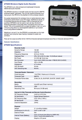

I'm just wondering if this little (and I do mean little) audio recorder would work with the EX-1. It has time-code, but aside from seeing cameramen I used to work with sync things up with time-code and their betacams, I've never done this before. I wouldn't want to invest in something like this and then have problems in editing.
I'll try to add a screengrab below.
Regards, Malcolm
new dig. audio recorder wi. time-code: work with EX-1?-zaxcom.png

It says it can stripe timecode internally or jam sync from an external source including wireless and conventional.
You do realize that it records only to mp3 and it costs $900 US? I understand it is small but...
Coffey Sound, a reputable sound gear outlet sells them. Might want to give them a call.

Andrew... just checked the Coffey web site and I see that the Zaxcom, as well as recording mp3, records "24 bit / 48 KHz timecode stamped broadcast wave files". I'm not saying it's not overpriced... but something that tiny could be kind of nice, just to slip into someone's pocket (and this way I could record a third track, without a mixer - - which I don't own). I'll read up on the Tascam too.

On further inspection, YES, it does do WAVE files at 24bit/48kHz. That does change things for the better.
A selling point of the unit is adjustable "high pass filter" allowing you to get rid of rumble. On the negative the frequency response rolls off at 16 kHz. In theory this isn't great but practically speaking unless you are recording a lot of music with overtones in the high ranges you won't notice unless you are looking for it.
