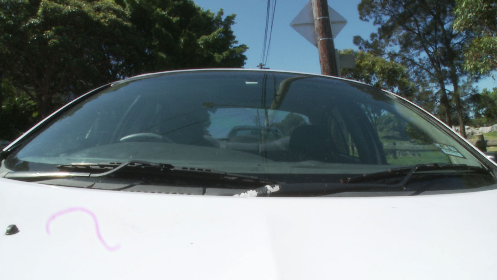

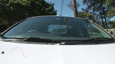

Has anyone ever come across this problem of a purple S shaped line (see attached photo) on there EX images?
At first I though it was something on the lens but after cleaning it was still there. I can't see any visible marks on the inside of the lens either. I then found that the mark stays the same size in the same place when zooming. I presume this mark must be on the sensor then but I also noticed the further I close down the iris the more visible and detailed the S shape becomes.
Would closing down the iris make a mark on the sensor more visible as it would on the lens?
Cheers

Not the best image for seeing anomalies. Can you post something without so much clutter? If you're shooting through vertical blinds I think there might be other problems.

To me it seems to be some kind of dust (the shape is just the shape of the dust particle) on the sensor or close to the sensor. When I have dust on my DSLR sensors it looks and behaves like what you describe. On DSLRs it's easy to clean the sensor. I guess it's not that easy on the EX1.

I had a purple mark appear like a hair in the gate on my EX1. Shake the camera and it moved! Sony put a new chip block in it at no charge.

Yer I've given it plenty of shake but no luck for me. I'm taking it to the repair centre today to see what they say.

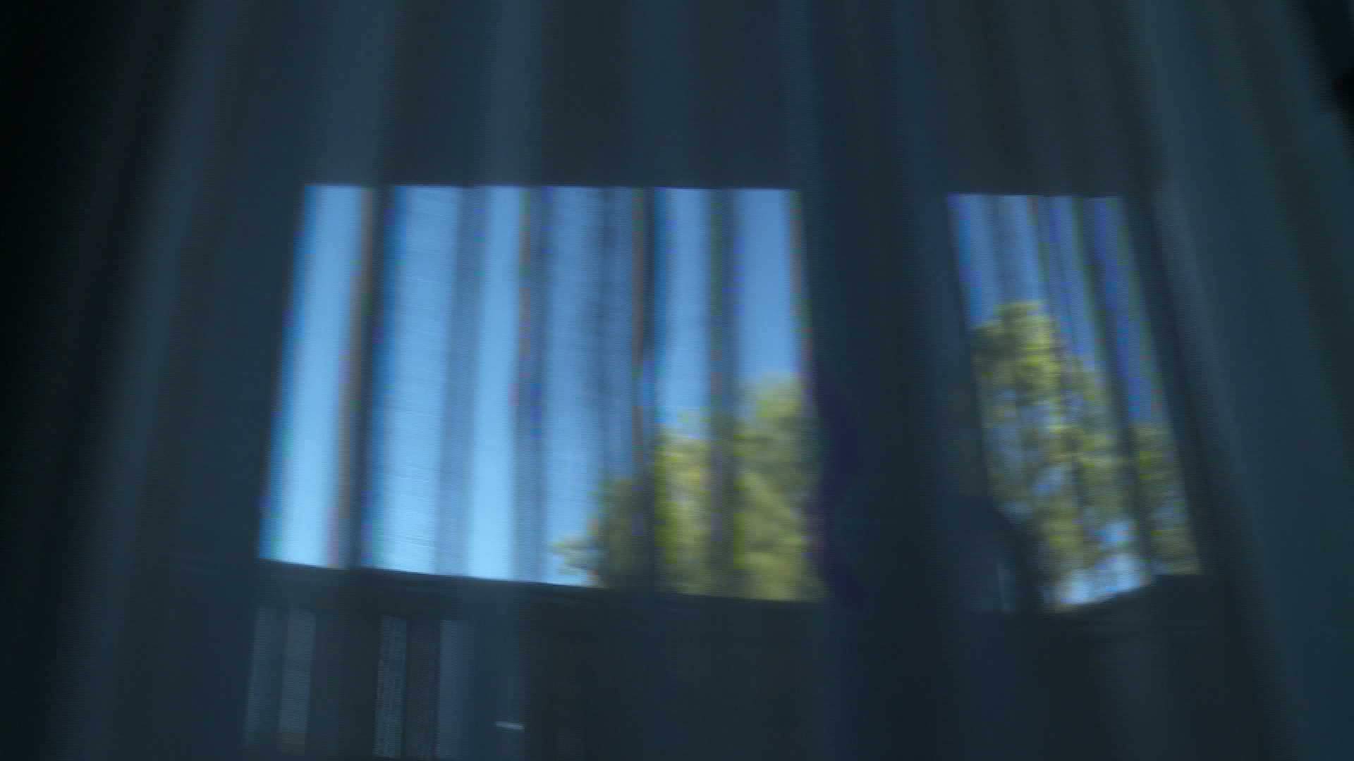

I seem to also have the same issue with my ex1. Like a pink line, which is less obvious with ND filters applied but still.. what to do? I have a big shoot on saturday.. camera was purchased 1/2008...

Yep thats the exact same issue I had. Same colour as mine so it may be on the green chip in the CMOS block if I'm thinking correctly.
I had to get the whole CMOS block replaced which was a pricey $2500 job. Lucky my insurance covered it in the end. That was through definitec Patrick.
