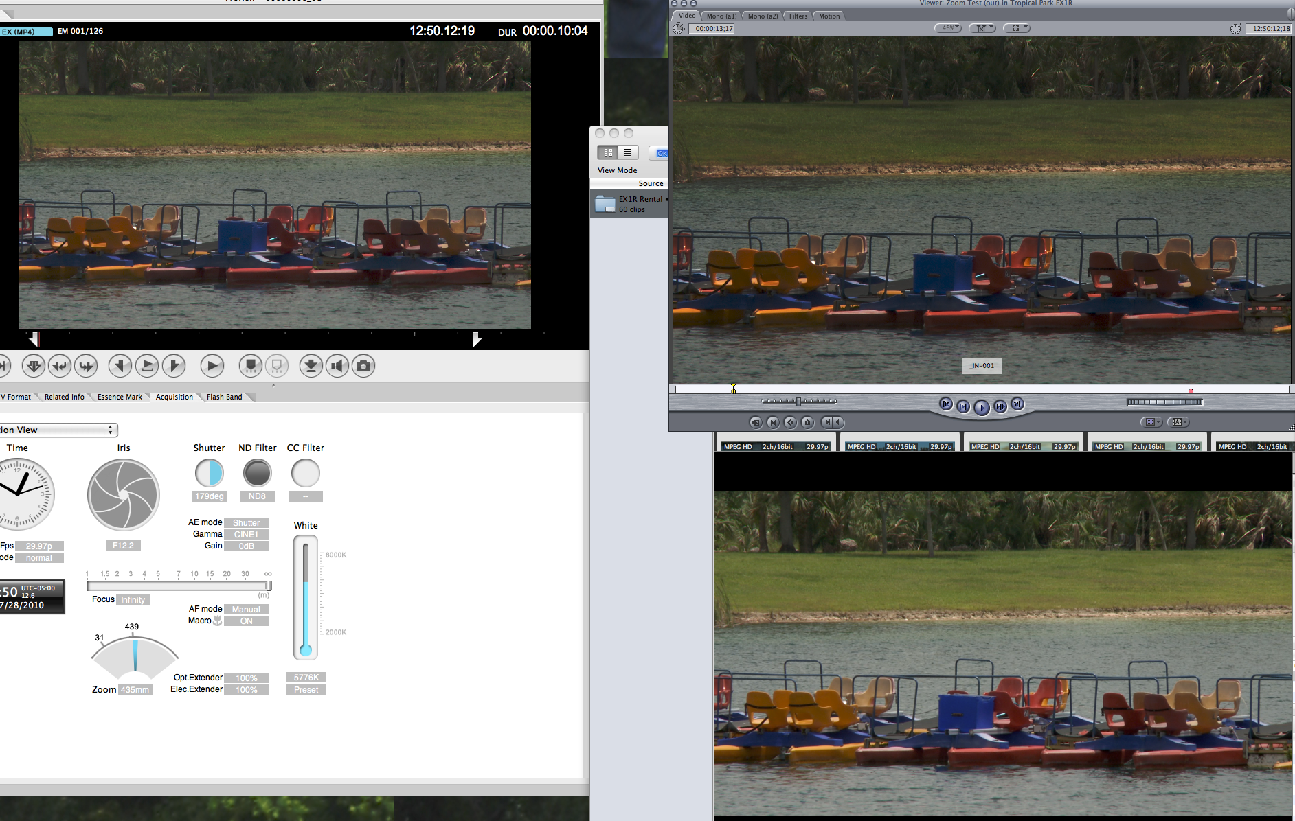

Attached is a screen shot showing the FCP viewer in the upper right and XDCAM Transfer in the lower right. Clip browser is on the left.
I don't know what I'm doing wrong. I followed the instructions in XDCAM Transfer and brought them in using FIle->Import. Any ideas why the clips are darker in FCP?
Why are my clips darker in FCP than XDCAM Transfer?-screen-shot-2010-08-13-10.56.54-pm.png

Unless you're using FCP 7 where I think its been fixed, FCP lowers the gamma of your canvas because it was assuming that your Mac was using a flatter gamma of 1.8 instead of the 2.2 standard for video and I think PC's also.
If you open it in quicktime it will also be lighter and more accurate i think.
kind of a drag since lost of people set up their mac screens to a more contrasty & saturated 2.2 gamma anyway, so this only makes it darker . That's why its dangerous to color correct in FCP unless you iron that stuff out first.
I( think i got that right.

Leopard defaults to gamma of 1.8
Snow Leopard defaults to gamma 2.2
Quicktime 7.x has a General Preference "Enable Final Cut Studio color compatibility" that when enabled Source colors are read with 2.2 gamma and are displayed in a color space with 1.8 gamma.
Quicktime X, which is exclusive to Snow Leopard, doesn't have such preference.
Basically Snow Leopard straightened things out but Leopard (and earlier) is a bit of a mess.
Leonard has the right idea but it's the OS that's at issue.

I'm on Snow Leopard, FCP 6 and an Apple Monitor HD display. I can't tell what gamma settings are in the display's profile but when I calibrated my displays, have one display using 1.8 and the other 2.2 so I can see what my video will look like on Windows.
The screen shot came from the 1.8 display and that's what I was puzzled by. I don't the the QT preference is at play here since that controls how the QT player renders video not how FCP renders it.
Are you saying the problem is that I'm on FCP 6 on Snow Leopard and if I upgrade to FCP 7 the issue will be fixed?

Macs with Snow Leopard are using the same gamma as PCs 2.2. So the above generalization no longer holds true. That's part of the problem that I believe Les is experiencing.
He's using Snow Leopard. He does need to check the gamma of his monitor just in case something has kicked it to 1.8 gamma.
Once he verifies the monitor is 2.2 he needs to examine the change in the gamma between CliipBrowser and FCP6. It's possible that FCP7 changes this behavior.
BTW ApplePro Res also has an advanced setting that forces 1.8 to 2.2 (it can be disabled). ProRes itself is 2.2 native. Perhaps something in the re-wrap from BPAV/MP4 to .mov is causing a push to a "darker" gamma cure.
Many of us certainly do have web as one of many final destination so one must have both a calibrated computer monitor and calibrated broadcast monitor.
It may even be possible that ClipBrowser itself was changed when it was updated for SnowLeopard. Sony may not have detailed that.
What is clear is that ClipBrowser gamma and FCP6 gamma in SnowLeopard aren't matching.
Les, are you using ClipBrowser 2.6? If not update.
BTW this is why, when someone reports and issue, they should include ALL version of all software involved.

I am using Clip Browser 2.6 and XDCAM Transfer 2.12. I calibrate by computer monitors using a Spyder2Pro but the calibration prompts for the gamma. As I mentioned before, I do one at 1.8 gamma and the other at 2.2 but I couldn't find anything in Color Preferences that confirms the display's gamma setting. My screen shot was from the 1.8 monitor so I thought it would be "right" ... the 2.2 monitor (as expected) just makes everything darker.
I appreciate the help in understanding the "color chain" as it were from camera to re-wrap to OS to FCP. I think I need to recalibrate my computer monitor and upgrade to FCP 7 to clean up the chain.
