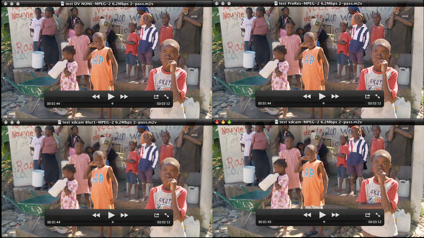

Hmmm, I've been using the workflow of copying the edited XDCAM timeline to an SD DV timeline with interlace NONE for DVDs. On a lark, I went from FCP 7 to a self contained XDCAM file and then used Compressor (Best Quality in 90 minutes) to create the .m2v files. I didn't see aliasing. On a lark, I tried the 3 workflows I've read here (DV, Prores, Blur filter) and they all look the same as the XDCAM: No Aliasing.
I looked all through my clip and magnified various stills but the XDCAM to m2v is as good as the others as far as aliasing and a bit better than the DV and Blur Filter versions in clarity. Has compressor been fixed by some chance? Is anyone else seeing this?
