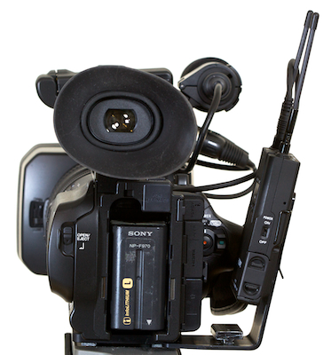

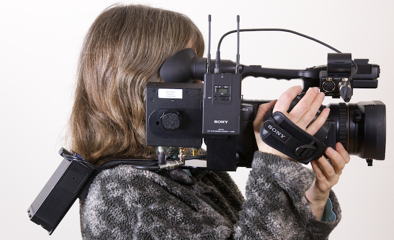

I make a plate and wing system for the EX cams as well as others.
Here are photos showing how wireless receiver mounts. This system puts the receiver in a very safe place and I have never had a problem with "interference" with this system. It works on any receiver. You can also mount NanoFlash or many other accessories to the wing and arms. And there is a shoulder system available as well. This also adds a very strong stable tripod plate to the camera.
If you are interested contact me or go to my website:http://www.westsideavstore.com/

Tnanks Barry, WRR810 is a old model, No warranty at all.
Thanks Olof, I interesting in EX1 Tripod plate.
