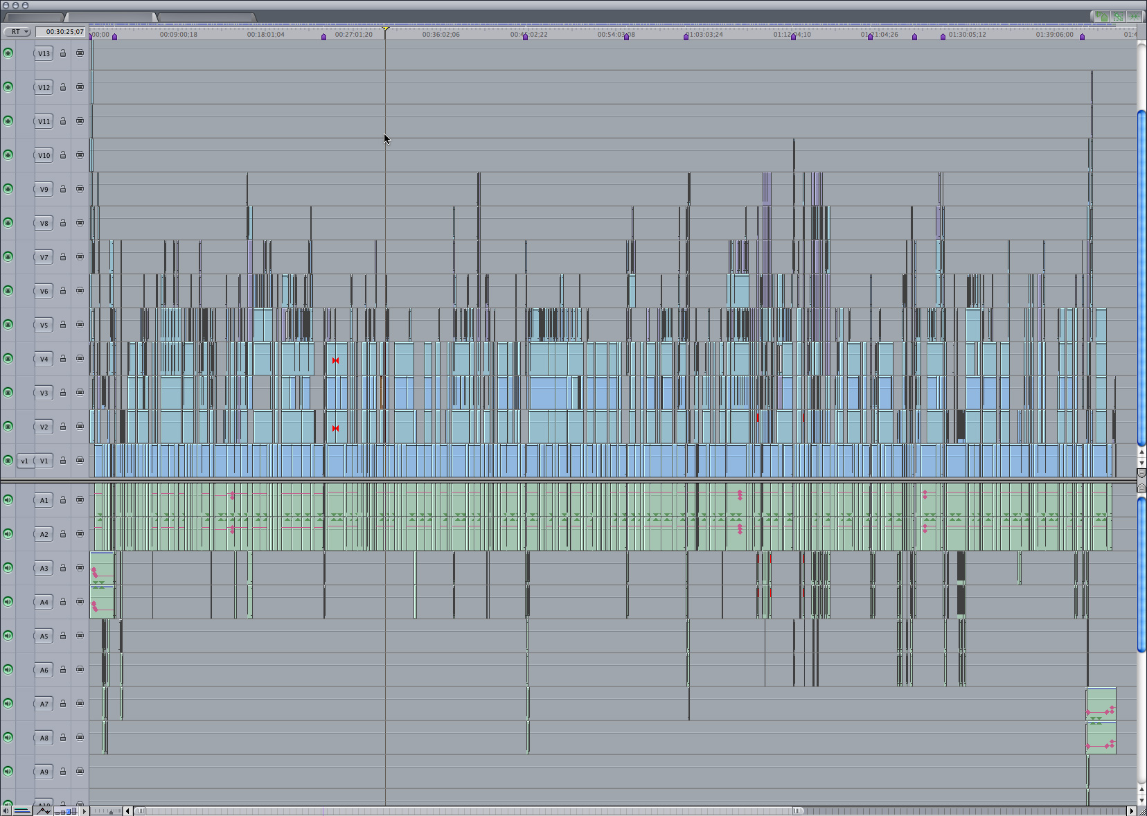

David, there are several reasons why I don't edit with an HD timeline if I will not need any HD output.
1) My DVDs typically contain a lot of graphics, charts, animations, etc. and it is easier to create those at SD resolutions.
2) Video footage downscalses easily, but graphics and animations are trickier. By editing with an SD timeline I can see EXACTLY what they will look like, and thus avoid potential problems that wouldn't manifest themselves until after I'd rendered the whole thing. Some things that look good in HD don't look so great when downconverted.
3) I can scan & pan the HD footage to change the composition whenever I choose.
4) I can key-frame fake zooms or other camera moves.
5) There is no rendering at the end of the editing. Even a 2-hour program can be exported in just a few minutes. This is especially important if I get into the DVD authoring stage and notice any editing problems (such as a flash frame or graphics typo) that need to be corrected. If the sequence was done in HD, then I may have to re-render the whole thing and that could take hours. But, if the sequence is SD, I can make the change and export a new version in a matter of minutes.
6) I believe the quality of the finished DVD is superior if I have edited with an SD timeline rather than downconverting at the very end.
7) Other proprietary reasons that I choose not to disclose here.
Of course, if I do need HD output, then, of course, I will edit with an HD timeline and downcovert at the very end. Different workflows for different needs.
Here's a screen shot from an SD project I'm editing right now. Do I really want to create all this in HD just to throw away the HD timeline and downconvert at the very end? Seems like that would be a waste of time to me.
