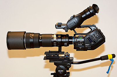

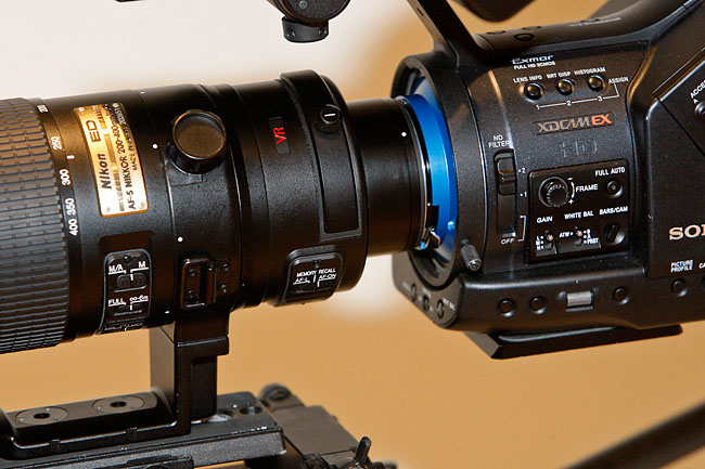

New Nikon G to EX3 adaptor with Nikon G 200-400 f4 VR photos
Here are two photos of my new awesome combo –Sony PMW EX3 with the Nikon 200-400 G f4 VR. The blue ring is part of the adaptor.
This is the first time the new modern Nikon G lenses can be mounted on the EX3 using Mike Tapa’s new patent pending adaptor.
Mounts and Adaptors
You can now have a control on the aperture even with these lenses which don’t have an aperture ring - making it possible to enjoy the quality of the superb Nikon lenses such as the Nikkor G AF-S 200-400 f4 ED VR.
I guess there will be remarks as to the lack of a support system - I have been working with a similar system for nearly a year now and it’s just great. I will need to use the bar system just in order to mount the follow focus.
The blue and yellow rubber bands (modified balloons…(-: ) are used to control the movement of the fluid head without touching the handle.
Will post some footage obtained with this combo on my website in a few weeks.
Cheers,
Ofer
Ofer Levy Photography

It's about time someone did it, well done to Mike Tapa!
The 200-400 is a good focal length for the EX3 I have always thought, as long as you have a 2x focal length ratio in the zoom it's enough two shot sizes that'll cut (ie mid and cu), and that lens has an A1 repuatation on stills.
