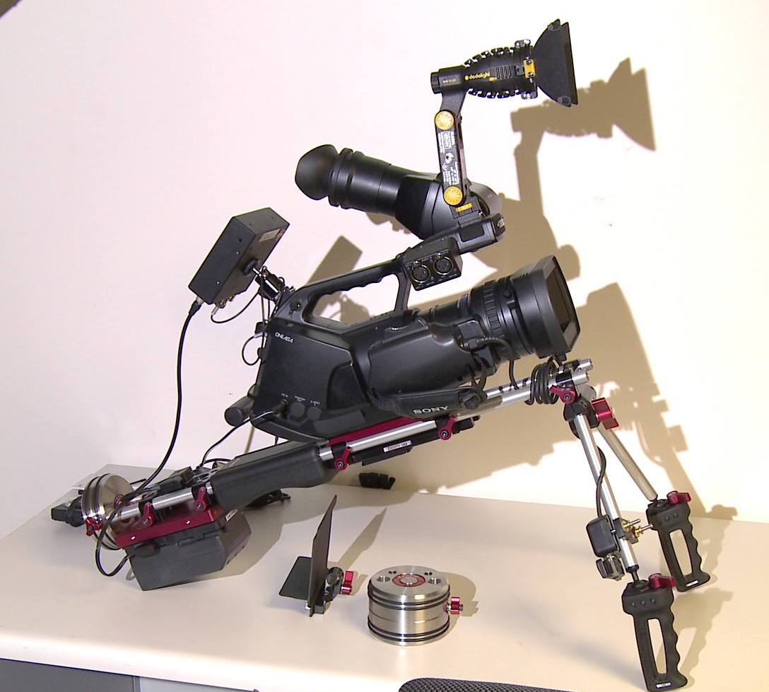

If you can, consider the Litepanels SolaENG 3 which is similarly priced to the Dedo but outputs WAY more light. I have 2 SolaENG 3's and one Dedo, and I use the Sola 90% of the time on my EX3 rig powered by V-mount batteries from Swit.
I have these 3 lights with v-mount batteries so I can do interviews with a quick 3 light kit anywhere I want with no need for AC power; however, I also bought 2 Frezzolini AC to D-tap power bricks to power the Sola's.
The Dedo can be purchased with a Sony or Pann battery plate in addition to purchasing their d-tap cable. On my EX3 rig, their d-tap cable does not reach my d-tap ports so I use a Zacuto/Swit cable that plugs into the battery's d-tap and has 2 connectors: 1) one is to power the camera and 2) is a female d-tap to connect to the Dedo (or Sola).
My only issue with the Sola is its fan. For on-camera use, this fan and on-camera mic's don't get along. Also, the 2nd Sola I received had a bad fan. In addition, I found the fan to become rather loud after an hour or so of continuous full-power use such as when I used a Sola as a backlight for a greenscreen shoot. The fan isn't audible from a few feet away so it didn't affect my boom shotgun mic but when the shoot was finished, I noticed how loud the fan had become.
The Dedo is fine for lowlight situations and has enough power to add fill in slightly brighter indoor situations. However, it is not wide enough to cover 2 people whereas the Sola has enough coverage and power for 2 people.
From my testing, I find the Sola equal to a 240 watt tungsten - very close to an Arri 300 to which I compared.
