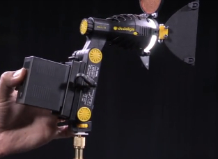

In a YouTube video, they've got the light+battery unit attached to a light stand (see screen-grab):
I'd like to attach this light/battery unit to the top of my Sony EX-1, for shooting at night (I shoot alone, by the way), hand-held, moving around a lot.
Do you think attaching this to the 'shoe' attachement on top of the Sony would make for a very ungainly, hard-to-balance load? Has anyone tried it?

I haven't actually tried it but anything you can do to reduce the weight at the top of the camera is a plus.
Get yourself one of the 3rd party batteries with a D-Tap, you will be glad you did. I run the Comer 1800 off the big PL-U95 battery via D-Tap and that arrangement works very well.

Malcolm, buy a couple of those long batteries, and the Comer light. Also, buy the "small" shoulder pad (along with the base plate) from Olof, you can also order the Hoodman loupe for EX1 from him.
With the big battery at the back, the rig will seat comfortably supported on your shoulder - with your eye against the Hoodman lope and your left hand supporting the lens hood as 2 additional support points. Very comfortable and steady.
Also, your left hand fingers are still free to operate the lens controls (your right hand is of course holding the camera in a regular way, operating the zoom rocker and start/stop button).
Recommended for handheld shooting.

The batteries do not connect to the camera via the D-Tap. THey have a short cable that plugs into the EX DC input. THere's also a D-tap for the light or whatever.
