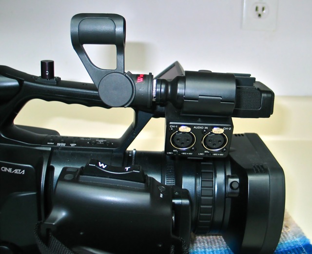

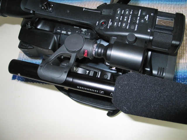

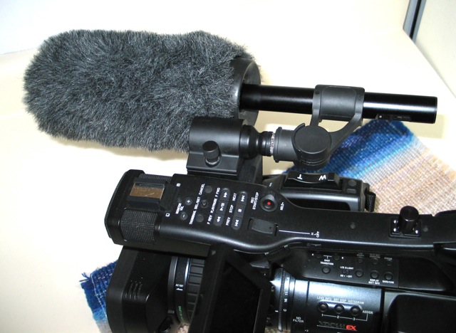

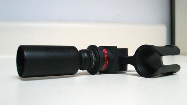

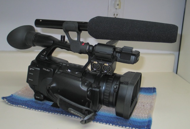

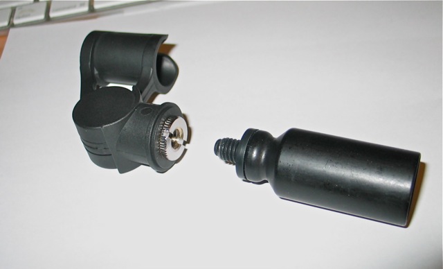

Hi Ollie. I'm using a Sennheiser ME-66 short shotgun with my EX1R, which is 3/4" longer than the NTG -2.
The adapter you see in the photos is actually 3 pieces. The rubber mic clip is a WindTech MC-12 but any 5/8" mic clip would work. A 5/8" to 3/8" thread adapter fits into the MC-12, then the tube clamp adapter screws into that. The whole assembly fits into the EX1R's mic holder. K-Tek has a clamp adapter kit that should work (K-CA) but I'm not sure if that's the one the shop set me up with.
K-Tek | Boom Poles, Microphone and Camera Accessories
It places the mic away from the lens a bit farther, which I needed when using my Rycote Softie. You can of course rotate the tube to place the mic in different positions. You could also insert it from the front side if you have a shorter mic that isn't going to get in the shot. Looks like there are other types of adapters that give more separation, but this is working just fine for me. Hope this helps. Please let us know what you decide on and how it works for you.
(After reading what Doug & Warren posted, I can see that it also has the advantage that if the mic gets whacked it should pop out of the flexible rubber mic clip. If you mount it directly into the EX1's holder it is solidly in there and no place to go)
Keith
