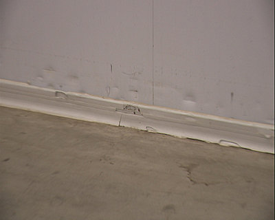

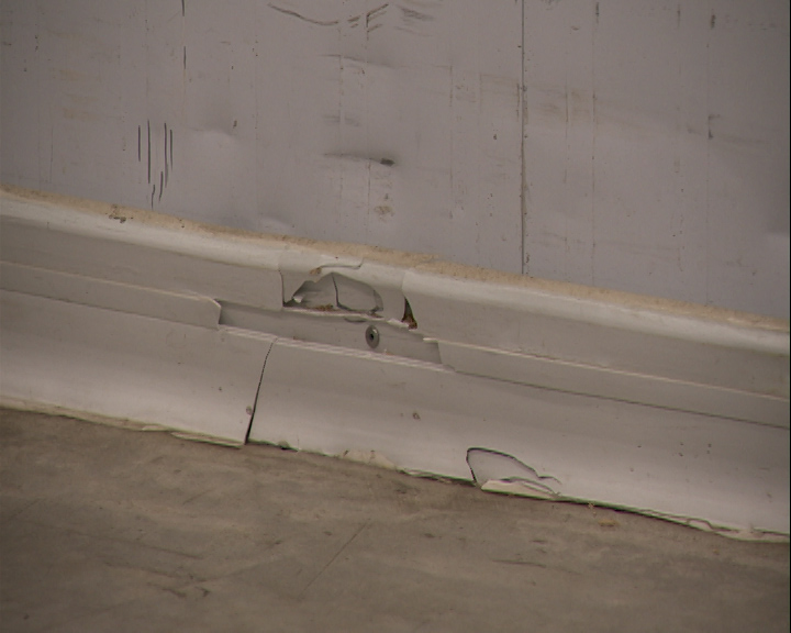

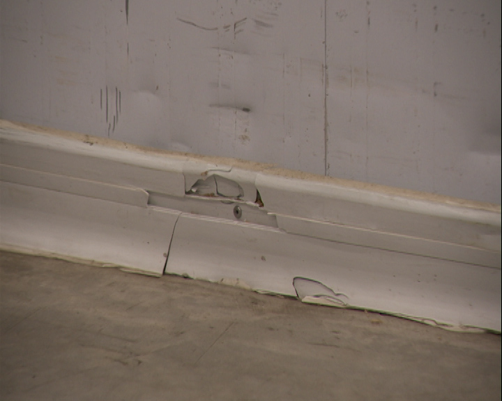

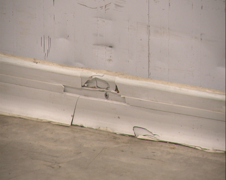

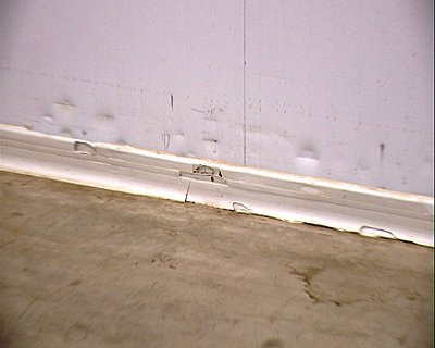

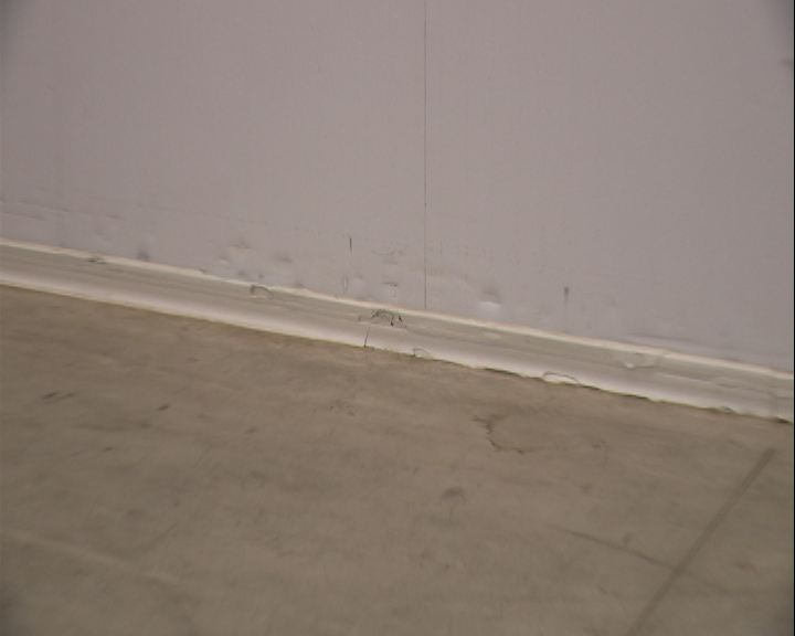

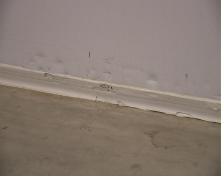

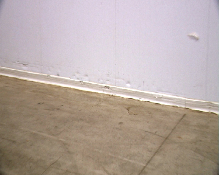

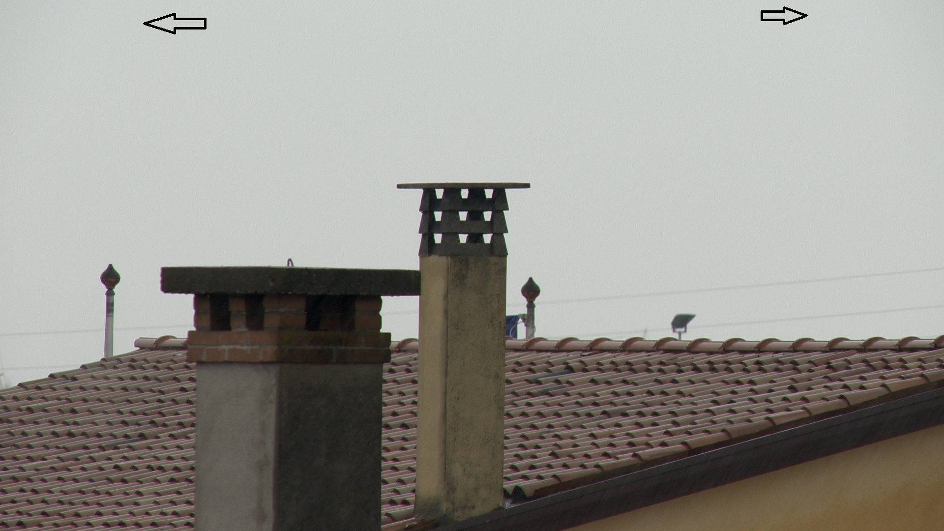

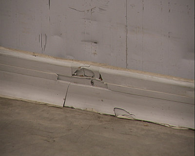

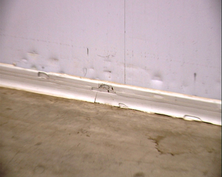

I have a big problem with my PMW-350,i have notice a shadow on all borders of the frame,a kind of a circle all around picture,i thought it could be the lens, but i have change the lens and the problem persist,any idea of what that can be? is it the nd filter? I have to take it to Sony service and I can't imagine how long it will take to repair it,I will be forced to hire another camera...is there any way you can help me resolve this problem or there is no choice but Sony service, I bought it 8 month ago...a real disaster..
Samer
here are some photo:
problem with PMW350-00001001.mxf.still001.jpg   problem with PMW350-00001001.mxf.still002.jpg
problem with PMW350-00001001.mxf.still003.jpg   problem with PMW350-00001001.mxf.still004.jpg
problem with PMW350-00001001.mxf.still005.jpg   problem with PMW350-00001001.mxf.still006.jpg

brighter photo
maybe with brighter photo you can see better..

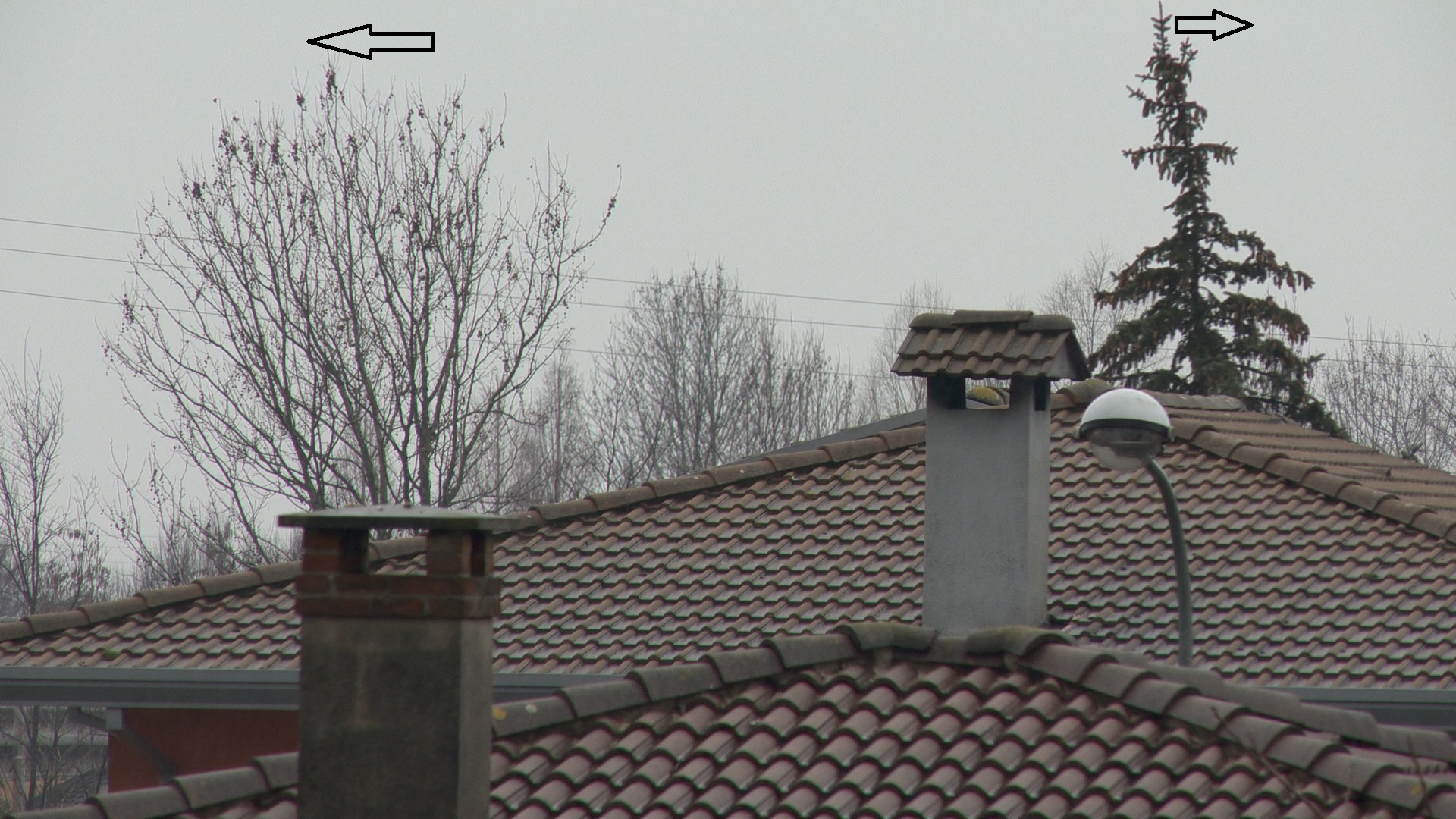

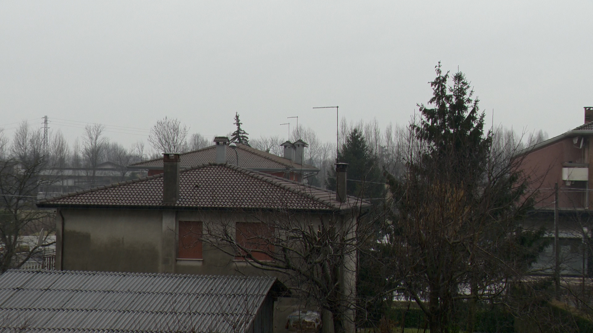

On the lens that came with the camera and on the other lenses that you have tried, try stopping down the iris from the maximum and see if the vignetting (or light fall-off) is reduced. Many lenses, and high-ratio zoom lenses in particular, suffer from vignetting at the max or near max apertures. This is quite normal and the vignetting would normally disappear on stopping down.
The fact that the pictures show vignetting that's symmetrical is a good sign your lens or camera does not have any defect in the optical path. There doesn't seem to be a problem with the built-in ND filters. You can test this easily by opening the lens wide and flipping the ND filters, starting from clear-ND1-ND2-ND3? and turning up the exposure in post to compensate for the darker images.

I think it was always there and I have never noticed that or that's what I want to believe and convince myself it's ok like that,I went to a Sony dealer that had another PMW-350K just like mine,and I have noticed that this thing aberration or a kind of dark shadow in the four angles of the frame, but I can notice that much worth in the right and left side on the upper part of the frame, the two cam gave almost that effect, maybe mine a little bit more and I have the feeling that if I send it to Sony service to repair it will come back the same as before and Sony will say that it doesn't have any problem, and I can't stay without a camera not even for one day...and from what they told me it won't stay for one week outside but maybe a month, NO THANKS...I need to know if there is someone else out there have the PMW-350 and notice this thing? how can you explain that?...it's not the lens, another cameraman told me you must try it with a good lens an expensive good quality lens and the effect will disappear...but I have to use this cam with the one I have and stock lens with PMW-350K...I hope that someone can tell me his experience with same camera.
I think that now that I have discovered this thing i will be more concentrate on that little spot in the frame angles than the framing and having a good shot...maybe I'm exaggerating but it will be very hard to turn on the camera from now on without having in mind this very worrying issue.

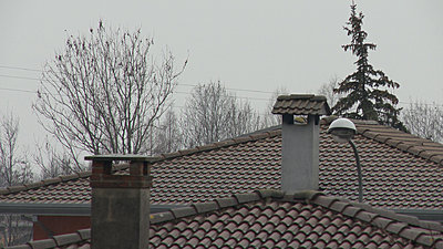

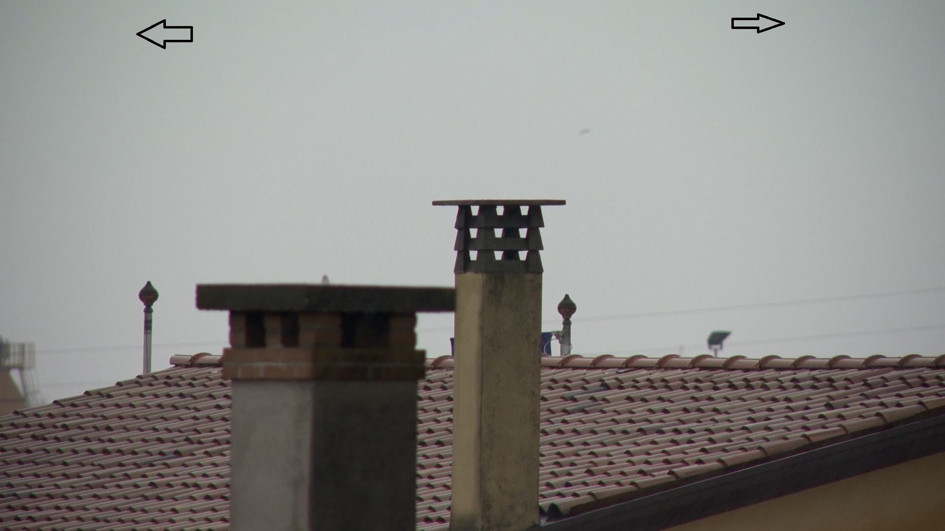

some other pic. I shot it outside today..I still notice that even with f5.6 aperture:
problem with PMW350-f-5.6-nd3.jpg   problem with PMW350-0191_01.mxf.still001.jpg
problem with PMW350-mxf.still001.jpg   problem with PMW350-mpm-0191_01.mxf.still001.jpg
problem with PMW350-mpm-0192_01.mxf.still001.jpg   problem with PMW350-mpm-0193_01.mxf.still001.jpg

Samer, I didn't notice anything like that on my PMW-350K, (shouldI say yet?) but I have got it only for a week and I haven't the chance yet to deeply test it.
I can tell that I have mount on front of lens a Tiffen UV filter, yet, I didn't notice any vignetting or degrading on image having added the UV Filter, but as stated above, I didn't fully test it yet.
