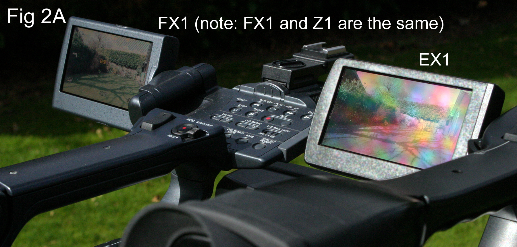

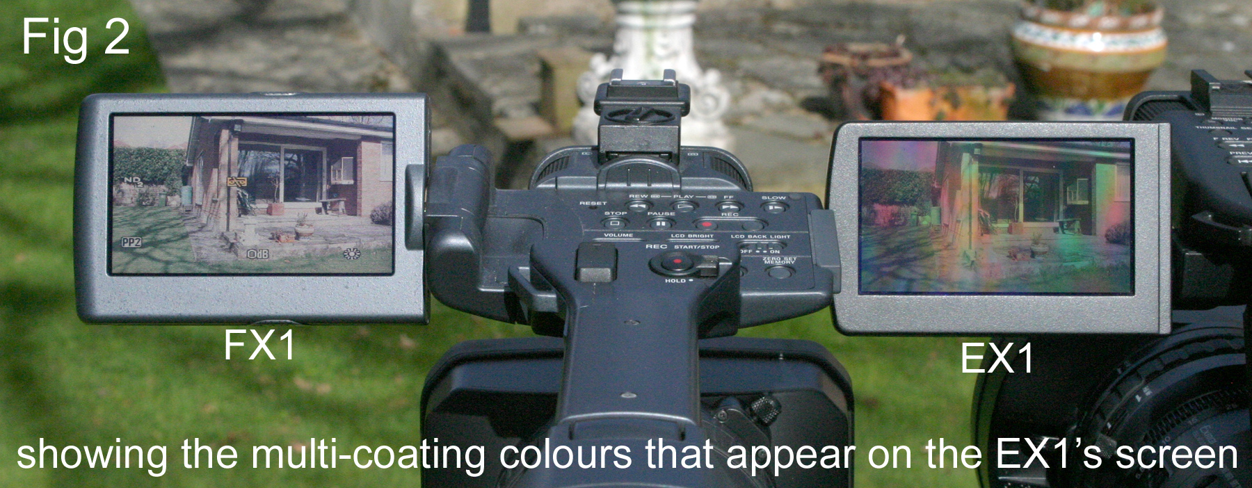

Dave, the Z1's screen is much better for composition than the EX1's in bright sunlight. It's nowhere near as sharp mind you, and this might account for it's far better visibility. Here's two pictures taken for a recent video article showing the strange 'multi-coating' colours that disrupt the image. Same with the NX5 and Z7 by the way.

Thanks for the pix! Funny, having gone from Z1 to V1 to EX1, I never did a side-by side of the screens like that. I suppose they're always tweaking something from one model to the next, and I never really noticed the differences that way before.
