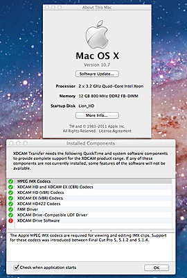

I have just done a clean install of Lion 10.7 v11A511 to test the functionality of:
XDCAM Clip Browser v2.6
XDCAM Transfer v2.12
XDCAM Clip Browser works as expected with no error messages.

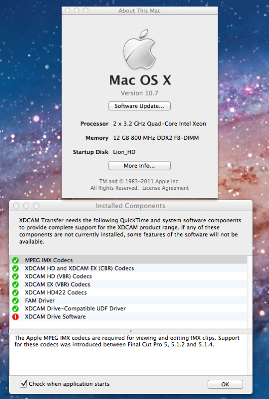

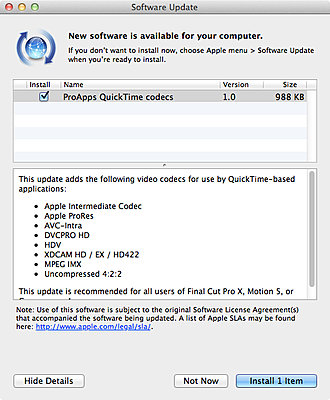

XDCAM Transfer will need FCPX installed so that the Pro App Sony codecs are installed. This is done using the Software Update from the System Preferences control panel. XDCAM Transfer starts as usual showing the Installed Components.

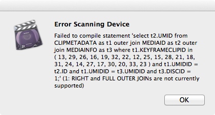

When you Add a BPAV clip for viewing, it will throw up a cryptic error message that does not appear in SnowLeopard. I have no idea what the error message means. After that the XDCAM Transfer seems to function as expected -- setting preferences all works, importing works as expected.
