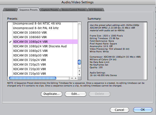

The bug I am seeing is that the Log and Transfer Plugin for FCP always assumes mono mix for importing clips. It was unpleasant to discover this after importing a couple hundred clips. My FCP Sequence preset shows audio is set to Stereo but unless I click the audio tab of the L&T plugin and change it to stereo for every clip, the ingest imports the audio as mono.

forgot to attach sequence settings. I noted the Capture Preset is defaulted to Generic Capture Preset which acts as a dummy I suppose. Nothing in there matches what is being ingested.
Any workarounds for this Log and transfer bug-screen-shot-2011-07-20-8.46.45-am.png
