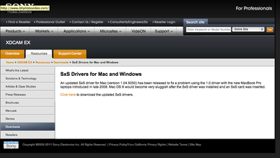

The website is up and that is the latest version
Sony | Micro Site XDCAM EX
Panic over Snow Leopard SxS Driver Kernal Panic-screen-shot-2011-08-02-6.09.42-pm.png

Sony's site tends to have some labeling issues.
Make sure the version you have has the file name v1052020 in the dmg.
The file date shows as April 21, 2011.

Craig is right. I clicked thru that webpage and downloaded the driver. The name of the .dmg is SxS_Device_Driver_v1052020.dmg
