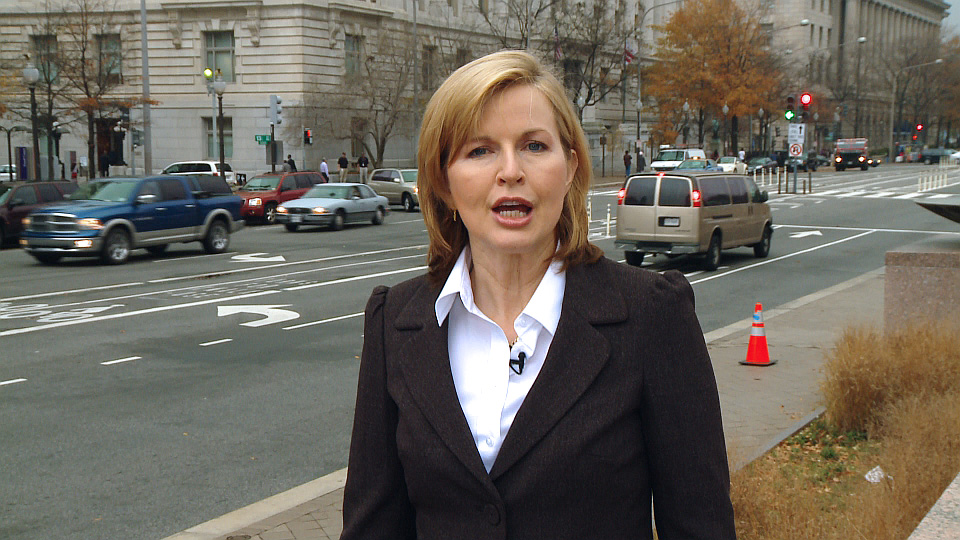

I am getting a yellow color shift on my EX3. This is something that just started happening 3 months ago, but today I really saw it.
At first I thought it was just the viewfinder that was looking a little yellow/orangeish. But looking at the video it truly has a yellow orange tint.
It doesn't seem to matter what format I use.
I am using PP Standard and I have not gone into the menu to change anything. I briefly looked at the settings and they all seem to be the default mode, at least I have not changed any settings.
I always white balance and often black balance.
I have been able to correct WB in post but I don't always edit the footage and have to dump into someone else's hard drive.
Not sure what is going on.
Ideas welcome.

Can you post a screen grab
He is one of original screen grab and one corrected in post.

Re: Yellow color shift on EX3
looking at the grabs it honestly looks like your WB is off. What did you have it set to when you were there? That's the corner of 14th and Penn right????

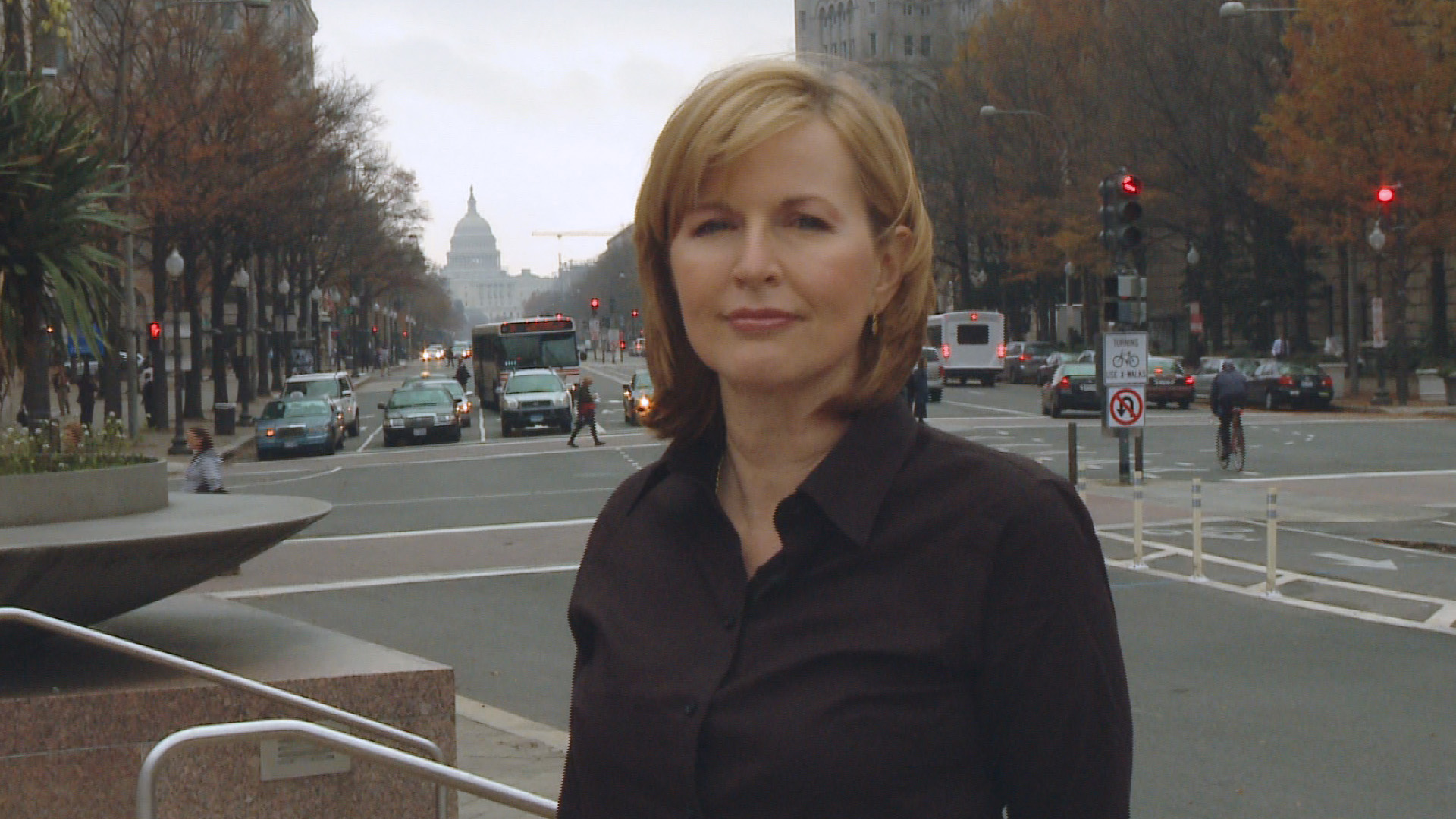

Here is another shot minutes later uncorrected and alittle yellowsish but on the other hand the blouse looks white.
Yes it is, at Freedom plaza surrounded by 100 occupiers.
I white balanced on a white piece of paper ...it was around 6300k if I remember right. I don't use presets.
That last shot looks really nice. Unless it does this consistently I would think that the WB was just off on that shot.

If you ask me this is nothing more than a wrong white balance and I disagree with Alister on this one. In both screenshots the whites show lack of blue.
Looking at your first screenshot, white surfaces (the roadsign just right of the talent) read about 10-30 lower value for blue channel compared to R and G channels.
Here's a simple correction done with an blue 80 filter with 25% strength
The blouse on the second screenshot is blown and I bet that it isn't white at all although it looks like the camera was balanced right on that blouse.
Looking on the large arrow on the street just left of the talent there's a 30-50 difference between R-G and B channels and again, 25% of the blue 80 filter got that arrow in the ballpark and evened all three channels out.
Other than that, I don't think there's nothing wrong with your cam.
Also check that the white balance offset is not engaged. And I would strongly recommend that you get a proper 18% gray card for white balancing. "White" photocopier sheets can be tricky sometimes, as you can see...
