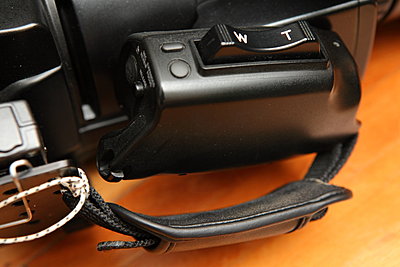

The outcome of this could be much worse, luckily it happened as I was shooting an interview and I was holding the camera with both hands, otherwise it could have ended by hitting the floor HARD.
And one more thing, I remember bitching to Curtis (Juice Designs — Welcome ) about the accessory arm being too close to the hand grip, boy did it save my ass on the field two days ago.
In case you're wondering, this piece of string I used for the fix is called Spectra and it's used by underwater spearmen as it's very, very tough.

the strap itself is not a problem but the plastic eyelet on the grip itself, you can see it's broken.
I was stunned by the service center's response, they said that Sony's policy is to change the whole lens instead of the grip itself, which is something I'm not going to do.
Does anyone know is it possible to get Sony replacement parts somewhere?

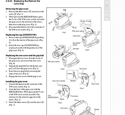

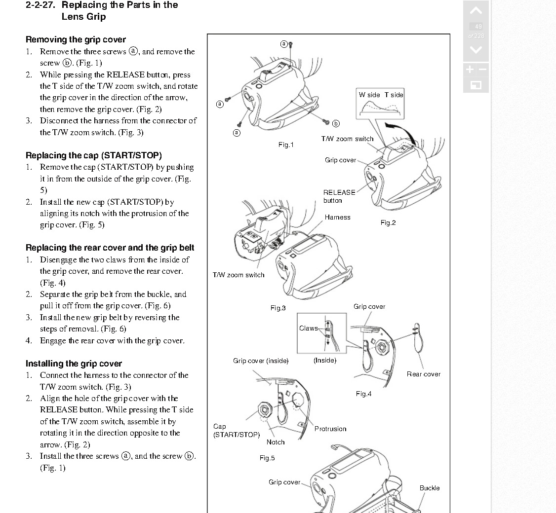

I've been studying the service manual and while they do describe how to remove the grip cover, there's no part number of it in the exploded view and I don't know what to look for.
Edit,
I've found on that web page that the ref. no. 631 lists as:
631 345246801 345246803 BELT GRIP $151.32
In the service manual the 631 is listed as:
631 3-452-468-01 s BELT, GRIP
$151 seems high for the belt alone so that should probably be the grip cover I need, what do you think guys?

nothing on this world is indestructible and meant to last forever and I'm not pissed about that, things break, they get repaired and everything's fine.
But I'm pissed when Sony wants to change the whole lens (a $2000 repair) because they don't sell a cheap plastic part which is actually very easy to replace (see the pic).
