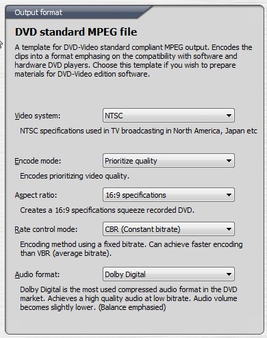

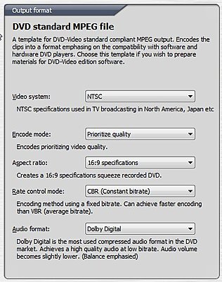

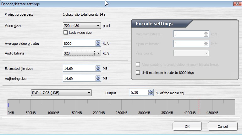

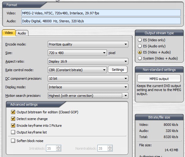

Shoot 720p60. Edit with project settings for 1280 x 720 and 30fps. Export lossless .avi file (Edius). Encode to mpeg2 using Tmpge4 SD-DVD settings in photos below. Use CBR if under 1 hour and VBR is over an hour. Author in DVDlab Pro.
Best way to shoot and export to SD-screenhunter_32-jun.-14-13.05.jpg   Best way to shoot and export to SD-screenhunter_33-jun.-14-13.06.jpg
