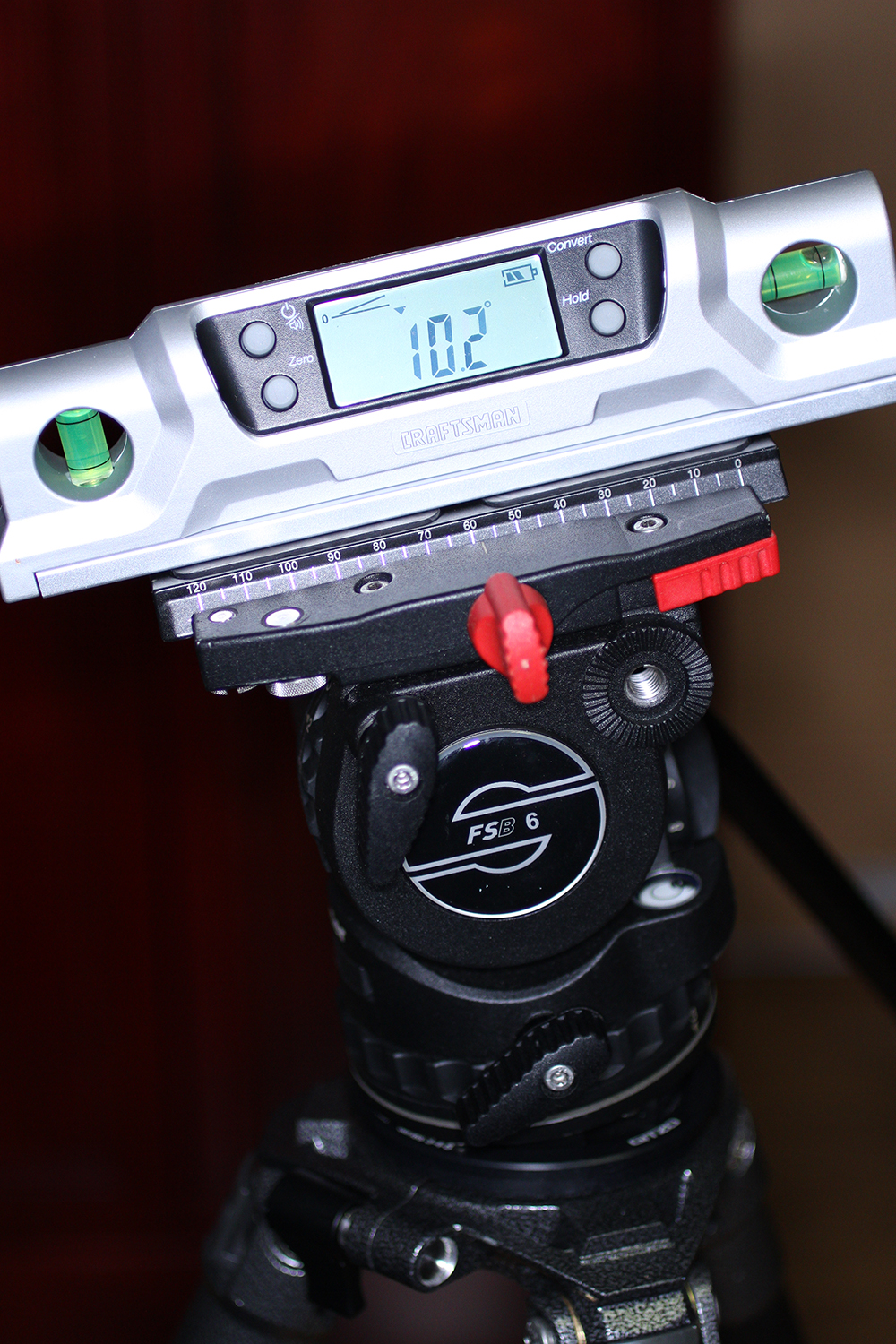

Sounds like a great combination. I have the Sachtler FSB-6 (75mm) with the CF legs. Recently modified my Gitzo GT3531 sticks by swapping out its center column-mounted flat top with the 75mm bowl top I cannibalized off a new GT2542LS set of sticks. The GT3531 being a Series 3 model, has the beefier legs compared to the Series 2 GT2542LS. (I couldn't locate a dealer in Hong Kong who had the Series 3 tripod with a 75mm bowl, so that's why I compromised.) The thing I wanted to mention is that the amount of adjustment I get on the FSB-6 when mounted to the Gitzo sticks is actually more than on the Sachtler sticks. With your choice of the 100mm bowl, I'd think it'd be safe to assume that you'll also have sufficient leveling range. I get roughly +/- 10 degrees of movement now.
