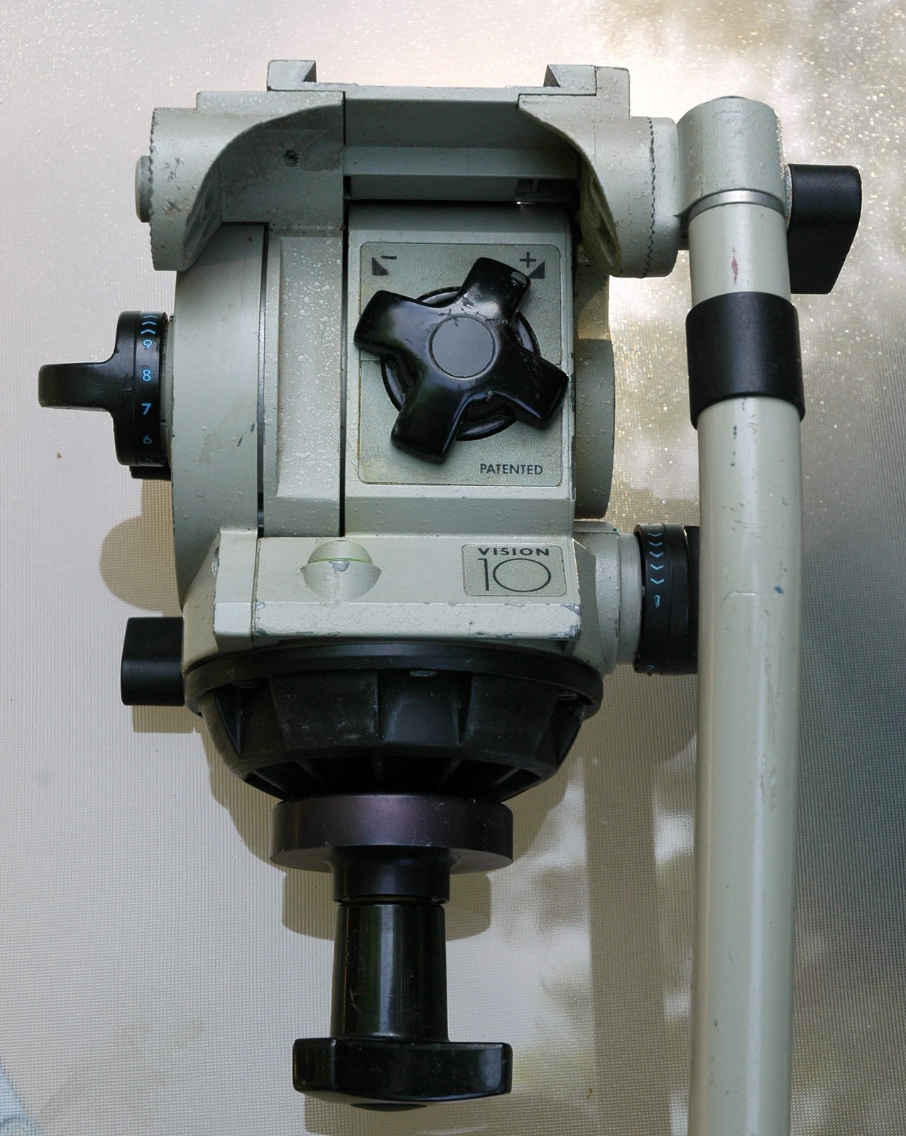

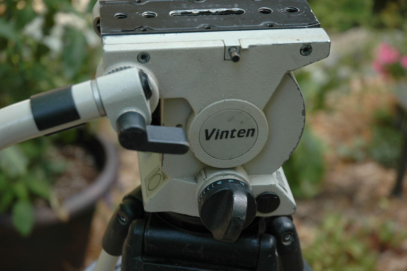

First is a Vinten vision 10 that is second hand. I have attached a couple of photos of that one. Would this be any good? Also i am looking for a Sachtler 18 second hand. Sounds like if i can pick one of these up second hand i would be getting myself a really good head. I am also still not ruling out something like the Miller Compass 25. Does anyone have any experience with that head & long lens'? There is also a Cartoni system here: http://www.bhphotovideo.com/c/product/740531-REG/Cartoni_F132_F132_FocusHD_System.htmlthat may or may not be any good. The price is certainly right, but there's not much in the way of reviews on it. Certainly the weight alone makes it attractive for hiking with!
Thanks in advance,
Bryce
