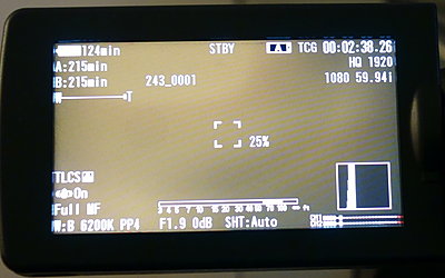

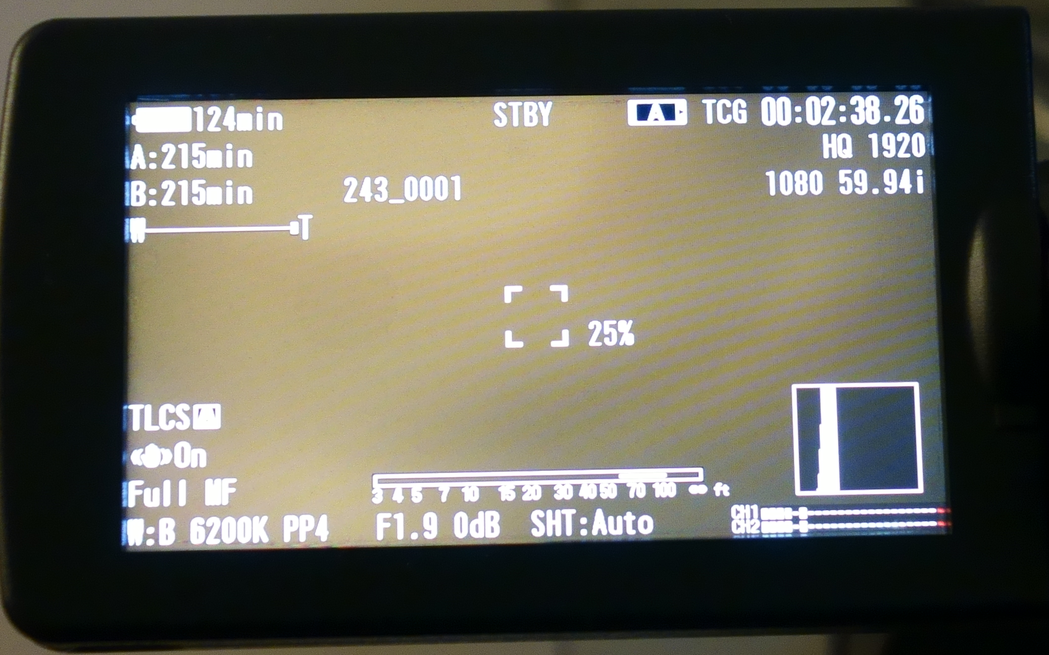

Rajiv:
LCD shows F1.9 at full tele zoom setting. Actual Fstop (T-Stop) may be different.

Originally Posted by Sara Jourhmane View Post
Rajiv:
Sara:
I'm no shutter-ologist, but I'd get rid of that auto-shutter setting. In fact, pretty much go manual with all your settings.

Re: Sony PMW-200 Brings HD 4:2:2 Workflow to XDCAM Camcorder Line
It's the same lens as the EX1, so even though it says F1.9 in the display, in actuality it's F2.8
Also, have to agree with Bill. If you have the shutter on, only use it in progressive scan modes (30p and 24p) in a shutter angle of 180 degrees. In 60i, shutter off is your best bet. (locked in at 1/60)

Bill W:
I turned the auto shutter off using direct menu and keeping the shutter on via switch on the side, as recommended by Alister Chapman. Thanks for noticing.
