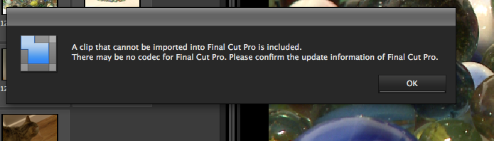

I haven't used my EX1 in sometime and I've recently upgraded my MBP to run Mountain Lion and FCP X 10.0.5.
I've done lots of reading and searches before trying to get everything up and running but I seem to be stuck. I've installed XDCAM Browser 2.1 and found a driver to get Mountain Lion to recognize my SxS cards in the expresscard slot of my MBP.
I open Browser 2.1 and select my SxS card. I can see all the clips and do in/out points and set titles, etc, but when I hit the "Import into Final Cut Pro" bottom I get a pop up window that says;
"A clip that cannot be imported into Final Cut Pro is included. There may be no codec for Final Cut Pro. Please confirm the update information of Final Cut Pro."
Has anyone had this issue and sorted it out? I have a few other questions about Browser 2.1 but wanted to get this first hurdle sorted.

No, there are no SD clips, only HD 720 clips. Even if I just have one clip loaded in Browser, I get that same message. I also downloaded from Sony the plugin for FCP X, but that's only needed if I'm capturing directly from my camera into FCP X, correct?
Does it matter what firmware I have on my EX1, I'm still running the original version that came with my camera in 2008. The camera never needed repair or service so I never had Sony upgrade the firmware. I don't think that should be the issue anyway.
Is there anything else I can check to see if that's causing the pop up window?

I've been unable to figure this out. Has no one else seen this pop up window? I've attached a screen shot of it.
I would like to know the benefits of using Browser 2 over just importing directly into FCP X, if there are any? After installing the plugin for FCP X I can import that way, so I'm curious why others might choose to still use Browser 2 for this?
I really appreciate any input. Thank you.
