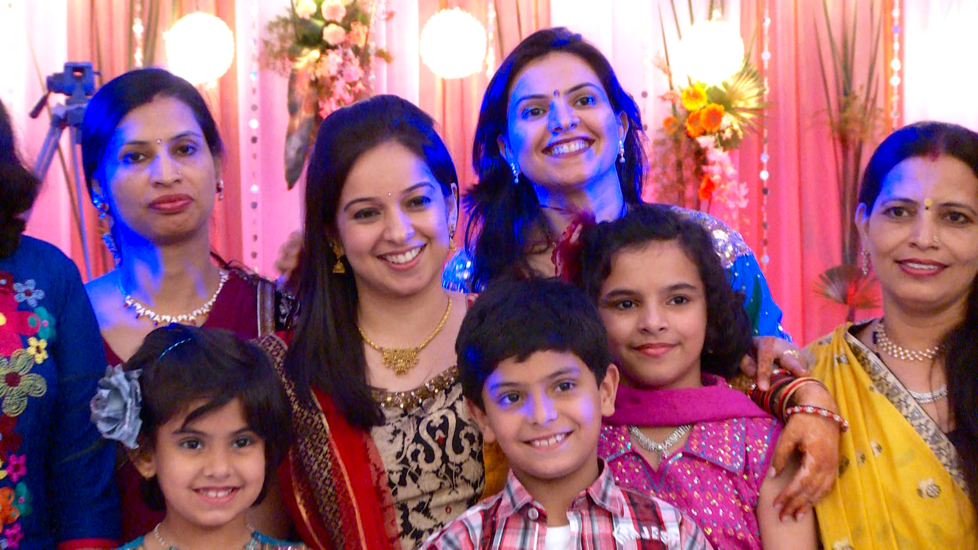

I have just purchased Sony PMW-200 Camera and ran into a problem.
The stage was lit with colour changing LED PAR lights
When the colour changes to blue the whole image becomes ghosty,
all the highlights are replaced with saturated blue colour
When the lights changes back to any other colour the problem disappears
The problem only seems to occurs with blue or purple lights
I have checked with another PMW-200 in the same conditions and the problem occurred in that camera also.
Is it a hardware fault or due to some camera colour settings?
Please guide

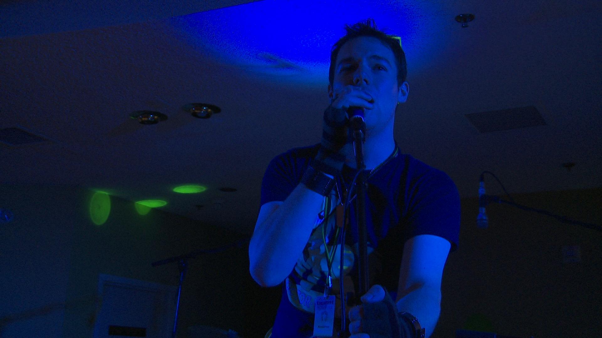

I had to work in a similar situation recently in Seattle, but the intensity wasn't as high since it was a dark room only lit by the color-changing LEDs. I opted to use the BBC Film profile on my EX1R (that uses the "Cinema" Matrix setting which has lower saturation levels) and was careful about adjusting gain and it for the majority of the time didn't clip any channels. (I mostly stuck/fell back to 6db when it started to clip channels at higher gain values)
Sony PMW 200 Blue Colour Cast-efnw0029_02.mp4_snapshot_02.37_-2012.11.20_03.39.jpg

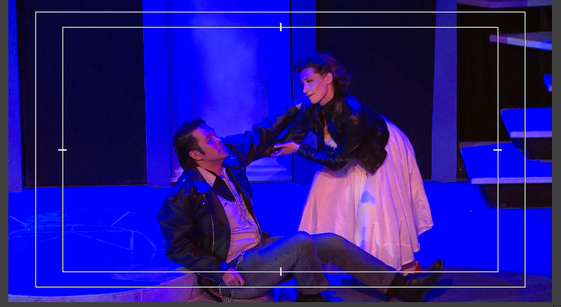

Is there any way to 'lessen' the saturation of the blue color only, after the video has been captured? Something that can be done in post that does not involve many hours? In some instances, it looks like shiny blue paint on peoples faces and the floor. Reminds me of Jim Carrey's movie "The Mask".

The challenge with trying to correct that problem in post is when you look at the scopes you will see that the blue channel has been clipped. As we know anytime data is clipped it is lost. You can reduce the blue levels with color correction but you will not likely get any more detail from those over-saturated blue areas.
So yes you can bring them down to make them less overwhelming but that won't restore a natural looking image due to the clipping in the chroma channel.
The best tool for the job to prevent this in the future is to have a field monitor with RGB parade waveform. That is a great tool to watch your color saturation and make sure you don't clip a chroma channel. These new LED lights can cause you to clip a chroma channel even when the overall luminance is in range. The normal build in exposure tools of the camera can't handle this situation properly.
Here are a few things to help the situation if you encounter it:
1. Set your white balance artificially high (higher K value). This will reduce the signal in the blue channel and reduce the chance of clipping.
2. In the camera image profile you can reduce the saturation. This can cause your final image to be a bit more noisy when you bring the saturation back up in post so don't lower it more than is necessary to avoid clipping. Going too flat is also a problem.
3. Have a field monitor with a RGB parade waveform so you can properly judge the exposure under these highly saturated conditions.
This will mean you must do more work to restore the image in post but the final image after correction will be better than what you get if you clip.
I strongly recommend getting your hands on some of these lights and do some tests with the settings and tools mentioned above.
