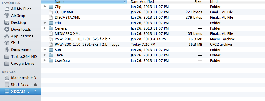

Hi everyone. I tried upgrading and i think i followed the instruction but the PMW did not detect any file in the SxS card.
Here's a screenshot of my card.
On the camera it says: 'Version Upgrade No File'
Could anyone tell me where I've screwed up please?

See if the file you downloaded was an archive. You need to un-archive it and the file on the card should be "UPDATE.BIN"
You could also try formatting your card in FAT mode for the upgrade.

Success! After a few tries, it worked!

I don't know what I did, but it worked after a few tries.
