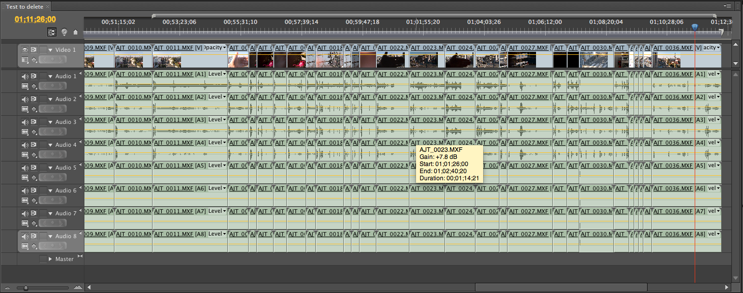

After dragging clips shot on brand new Sony PMW-200 camera into an Adobe Premiere CS5.5 timeline, there are be 8 channels of audio on the timeline by default. Four of the channels I can account for, but there exists 4 completely empty phantom tracks. What's up with that? Is anyone else experiencing this? Is it normal? If so, is there a workaround?
HDCAM HD422 8 channels of audio in Premiere CS5.5 timeline-8-channel-audio-premiere-cs5.5.png

Thanks for that research, Robin. It looks like Premiere users are stuck with four empty tracks. So, I guess there’s one more step, deleting those empty tracks before one can start editing. Here’s what I’m doing. Drag all clips into a timeline, then select tracks 5 through 8. Delete them. Then I’m left with four tracks of audio. Then I’ll delete tracks 3 and 4 (the channels that I have set to record auto-level camera mic) if they aren’t necessary for the edit. Can anyone recommend a better solution?

With those settings, when I bring in clips, I get four stereo tracks. Channels 1 & 2 create a stereo pair on track 1. And channels 3 & 4 create a stereo pair on track 2. Unfortunately, I also get two other stereo tracks that have no sound. As Robin says, the specifications for XDCAM UDF audio require 8 tracks. So I get a stereo pair ( 5 & 6) on track 3 and a stereo pair on ( 7 & 8) on track 4. None of the XDCAM camcorders can actually record 8 channels, so these two stereo pairs are always empty. But don't worry, it is easy to strip them off before you drag the clip into your sequence. In fact, it is really easy to strip off ANY or even ALL of the audio tracks from all of your clips in one step.
