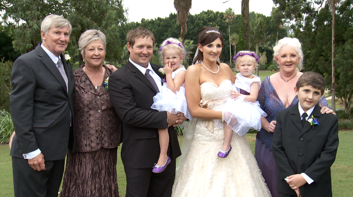

Hi Doug, here is a screen shot from the camera, the day was overcast, all of the image looked to the exposed ok, yet the dress and the whites are overexposed, and on a sunny day its even worse. Did you have a way of stopping the withes to blow out ? or a setting in the camera that i could try, re gamma setting , knee and so on... Thanks.

Probably the wrong thread for your question, but you may want to start by trying your hypergammas to see their effect. Get Doug's DvD if you don't already have it.
Remember, the sensor has a limited dynamic range (for increased dynamic range you could go with an F3 or F5/F55.) - but the dynamic range of the sensor is still greater than that of the recording format. Hypergammas help you capture more of the dynamic range, but bright whites can still blow out. That's why traditionally bright whites are not part of the allowed palette on dramatic shoots. If you absolutely want to keep detail in your whites, then expose to protect them. Use your Zebras to make sure nothing is exposed at or over 100%. If there are really bright areas and you adjust for them, your skin tones may become darker. You may then need to integrate color correction timing into your postproduction workflow.

Thanks Dave, the main question was about the white balance, and LCDs on the PMW-200. The Imaged looked ok on the day on the LCD, but in post there were a lot of over exposed clips. So I am going to have to learn more about trusting the setting in camera rather than what I see on the LCD.

If your white's are blown out then then you have over-exposed the image. Having a good picture profile and knowing how to setup and use the zebras will make it much easier to avoid blown out whites and still keep the rest of the picture looking great. Believe me, it not only is possible, it is quite easy in practice. BTW, if you're shooting with the camera's factory-default settings, you're never going to get consistently good looking images from the camera and blowing out the whites will always be a real problem.

Learning to trust the camera, after you have followed proper procedure for setting white balance and exposure, regardless of what your eyes are telling you from the LCD, is like a pilot flying in clouds and trusting his instruments rather than relying on his "perception" of what the plane is doing. Too many cameramen shoot video like JFK Jr. few his small plane, and that is not good. I hope you like the DVD because it will answer many of your questions.
