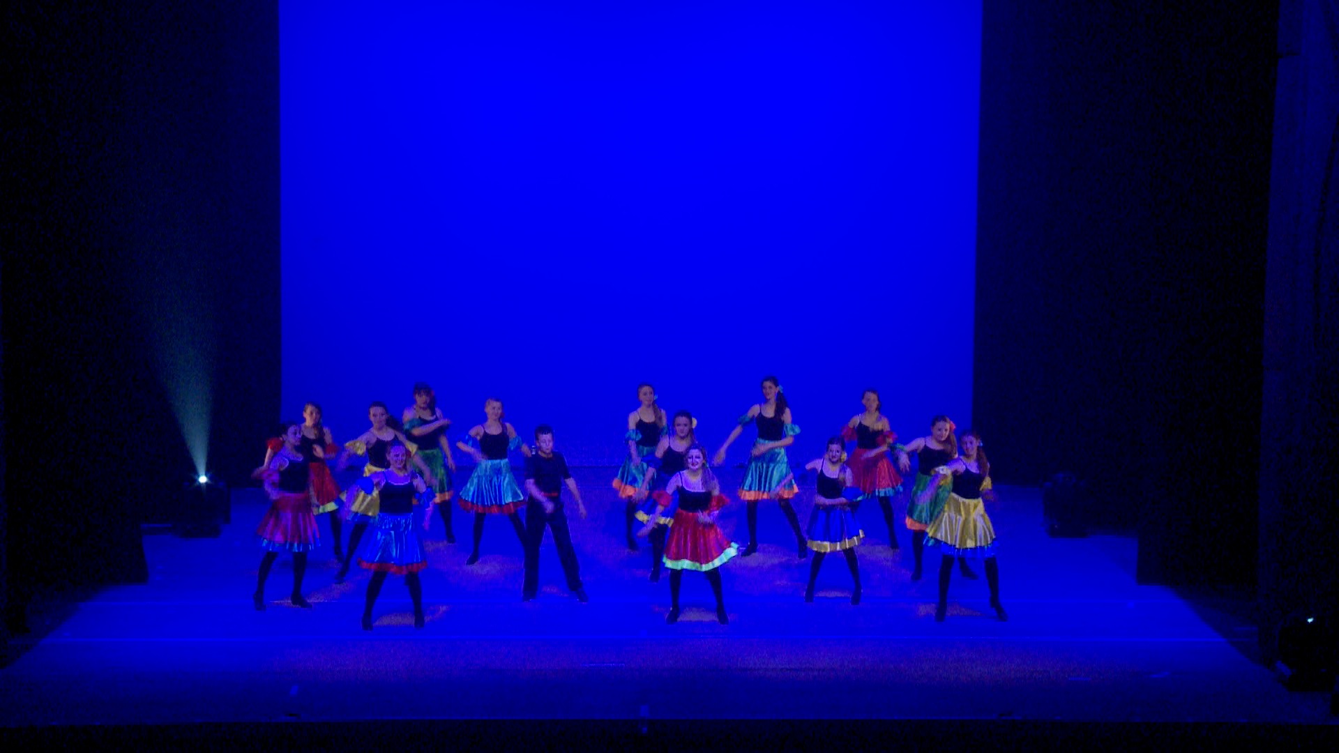

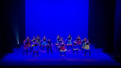

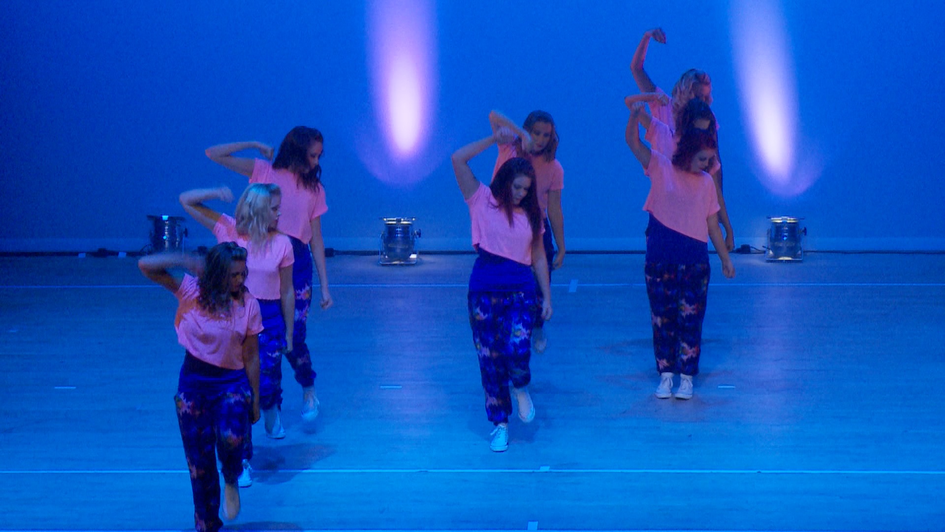

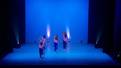

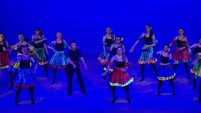

During post production of a recently filmed dance show we noticed that some of the numbers had inaccurately captured colour.
The two set of stills show two numbers close up and wide shot. The blue seen in both cases should have been a medium pink. Can anybody offer an explanation why this has happened?
Also what about the dirty shadows below the dancers feet?
The two EX3s were both set to 3200K white balance and + 3 db gain.
Shutter 1/100 sec
Format 1920 x 1080 25 fps (50i)
The lenses had the Tiffin IR cut filters.
The picture profile used for both cameras was.
Matrix turned on and set for HIGH SAT.
Detail level -10.
Cine4 gamma setting.
Master Black level -3
Black Gamma -2.
As originally suggested by Doug Jensen and used for the last four years .
We talked to the lighting man and he tells us a new Italian LED light was used for the back screen.
Clay Paky - A.leda Wash K10
The blue on the floor is we presume a reflection from the back screen. The floor is a polished wood stage.
Do LED lights give this sort of problem with the EX3 and similar CMOS sensor video cameras?
Any help greatly appreciated.

If you were in 3200K white balance for the cameras you could easily get this color if the LED's were at 5600K. Doesn't matter what camera you have. Lot's of theatrical lighting is in mixed color temperatures. Often requiring a compromise white balance unless you can go scene by scene. You can probably color correct in post to some extent

LED lighting causes trouble with most cameras. It looks to me like you clipped the chroma distorting the color.
Can you take a look at the images with a RGB parade waveform? What do the waveforms look like?
This is a situation where the traditional in camera exposure tools can fail you. I would bet that the in camera luminance values looked OK. The highly saturated colors that LEDs produce will easily send you over the chroma saturation cliff .

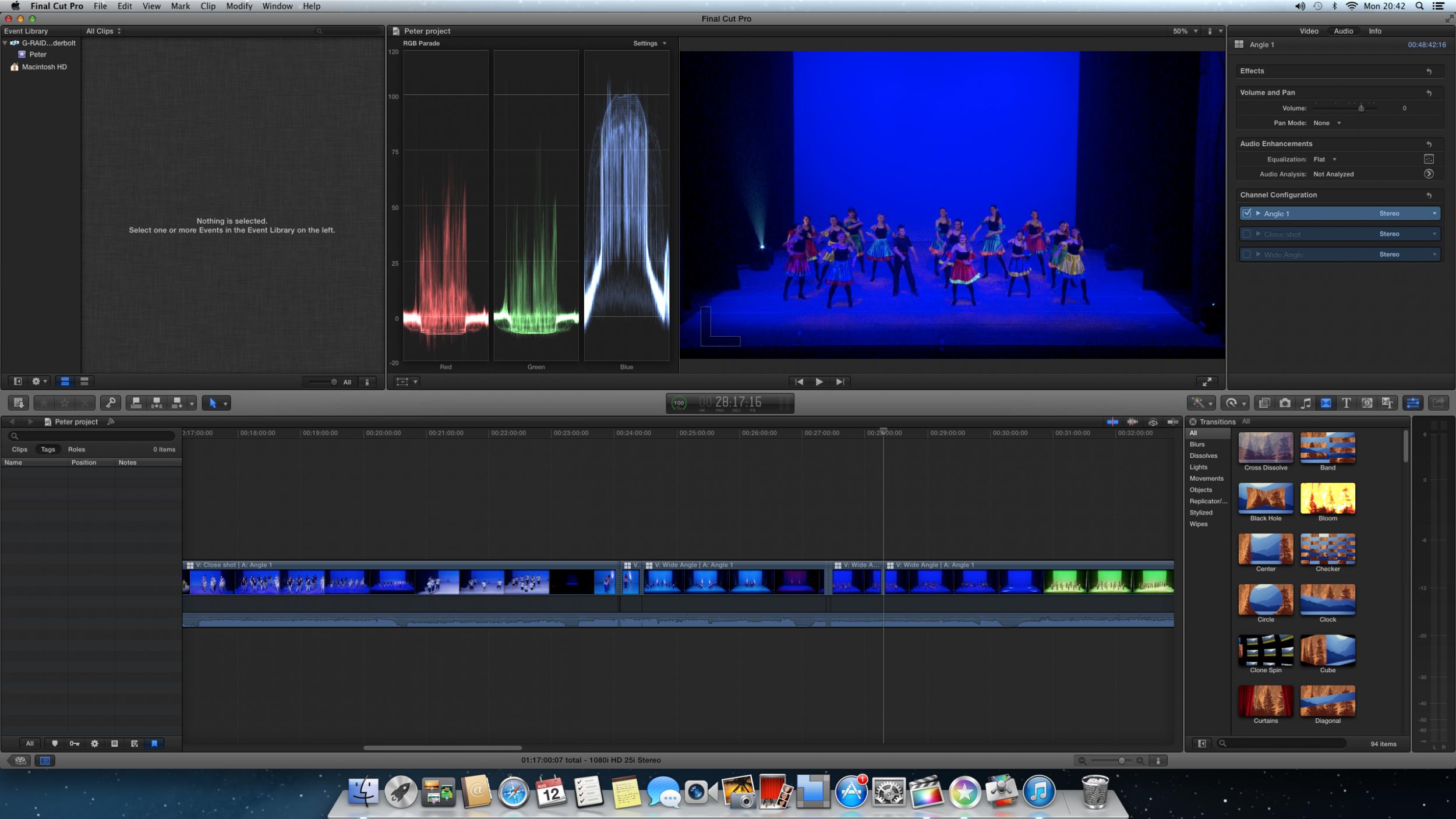

Here is a screen shot of one of the clips in question.
Greg Hawkes is offline   Reply With Quote
Old August 12th, 2013, 03:46 PM   #5
Location: Efland NC, USA
Posts: 2,322
Re: EX3 captured colour inaccurate
Hey Greg,
Looks like you don't have the clipping that I was expecting but for sure the blue channel is out of control!
You should be able to get something that looks OK with some serious color correction.
For sure that is a lighting thing and not anything wrong with the camera. The color balance between red and green look reasonable. It is just the blue channel that is crazy.
