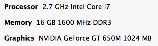

I think your LT is a bit marginal. More RAM may help but better CPU and GPU is definitely recommended. A fast healthy HD or SSD helps too.
This 4 core setup has absolutely no problems even editing and playing back several streams w/o rendering.
