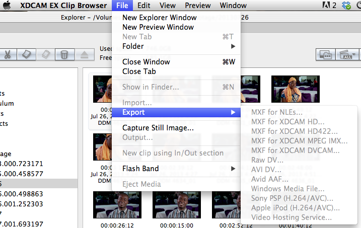

Sorry. It's been a while but it is Sony's XDCAM Browser utility not XDCAM Transfer that lets you export on a system that doesn't have FCP installed. I just remember doing it on a Macbook Air while traveling and using DV.
