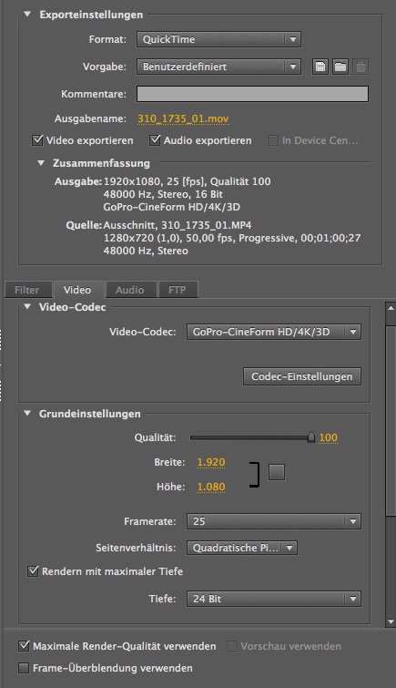

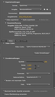

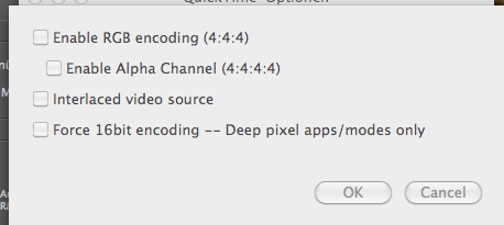

I downloaded and installed the GoPro Studio and now "GoPro-CineForm HD/4K/3D" is available as video-codec. Can i simply convert the file I want to rescale in Adobe Media Encoder and set the output-settings like this?
(1920x1080, Square Pixels, 25fps, Maximum Depth; i left the "Codec Settings" the way they were - everything unchecked)

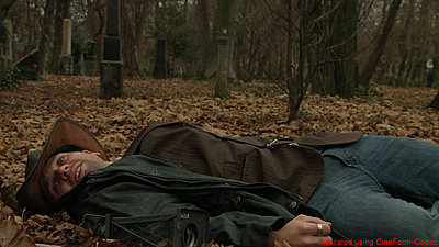

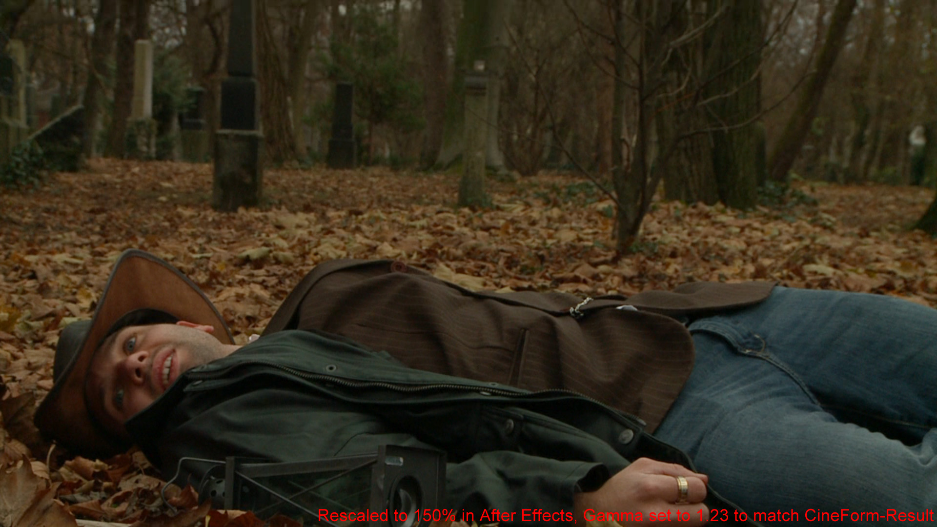

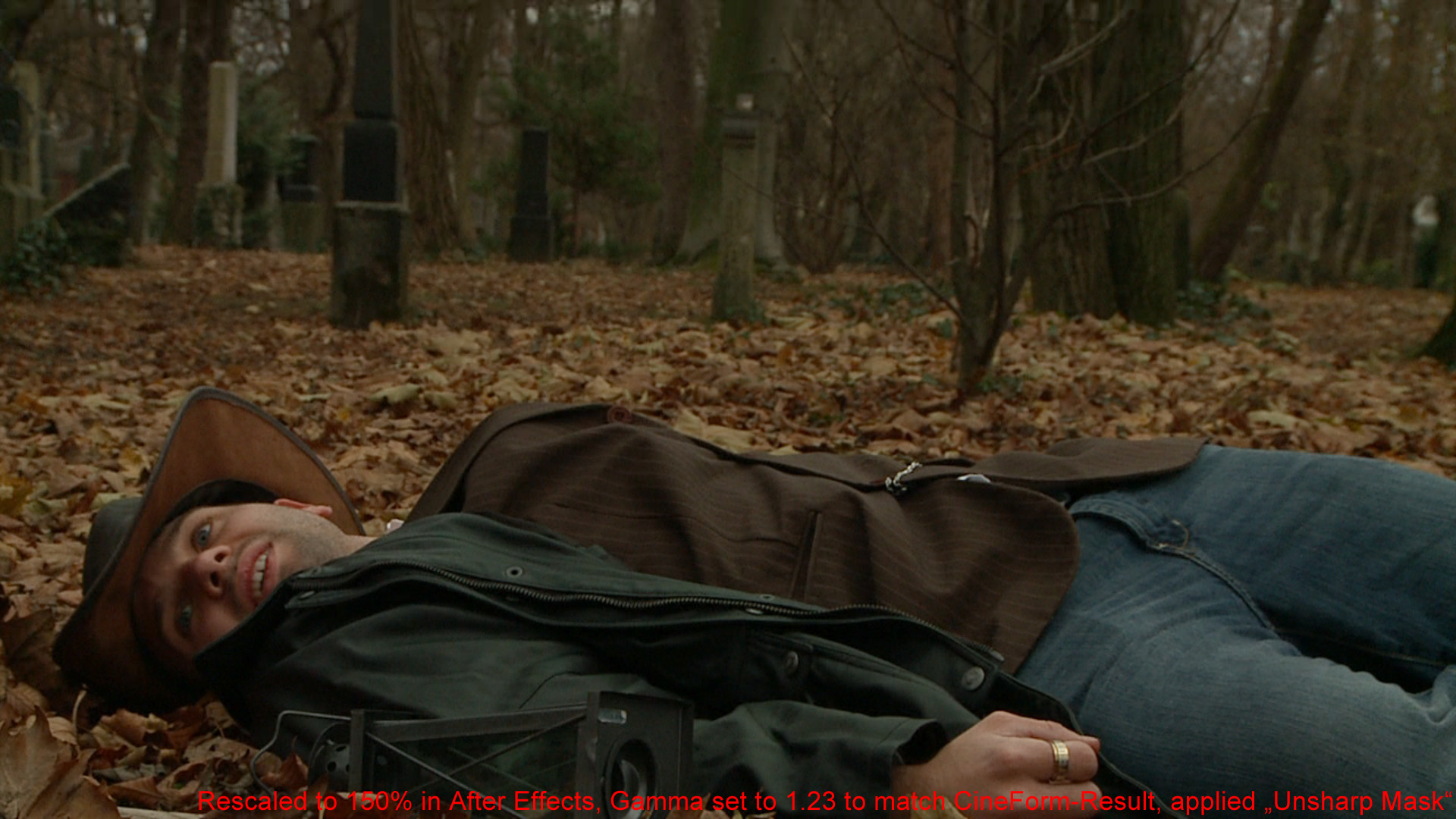

When I compared the results, it seems to me that the GoPro-Codec just brightens and sharpens the image a bit.
When I scale the 720p Footage to 150% in After-Effects, the GoPro-Codec seems much better. But when I apply the "Unsharp Mask"-Effect, i get very similar results. I'd even prefer the "After-Effects + Unsharp Mask"-Method over the GoPro-Conversion, because i got more controll over the sharpening Process and the result of the GoPro-Codec seem a litte more "digital" und "sharpend".

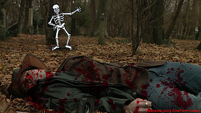

Here are some example-Pictures of a crime movie I'm working on.
best way to rescale 720-Footage to 1080?-gopro.jpg   best way to rescale 720-Footage to 1080?-ae.jpg

I'm a bit worried about the footage. He doesn't look very dead to me. Or ... way too happy for a dead person.
Thats why we have the miraculous wonders of postproduction... better? ;)
(jeah, i know he doesnt really look dead... its kind of a parody anyways)

Much better now. :-)
BTW, the Matrox MXO2 has a very good hardware upscaling/downscaling engine in it. You could always play the footage through and capture from the HDMI output (to a Ninja or something) and get your 1080 version of the footage that way.
