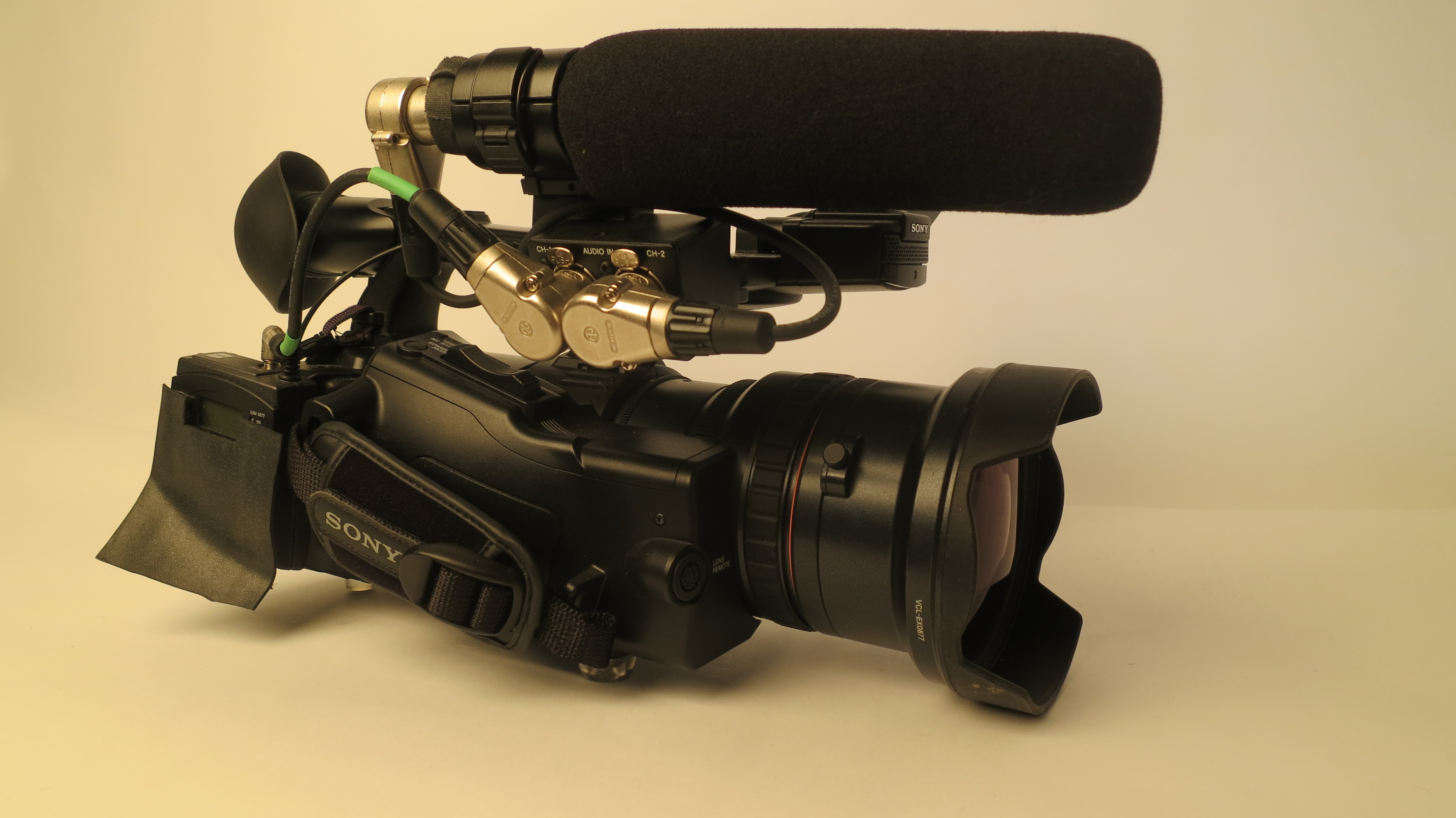

I got the Sanken CS-2 partly because I've had good luck with Sanken for other mics, and partly because it's a shotgun that's nice and short:
SANKEN MICROPHONE CO .,LTD. | Product [ CS-2 ]
Here's a shot of my PMW-200 with the Sanken CS2 attached:
Regards, Malcolm
