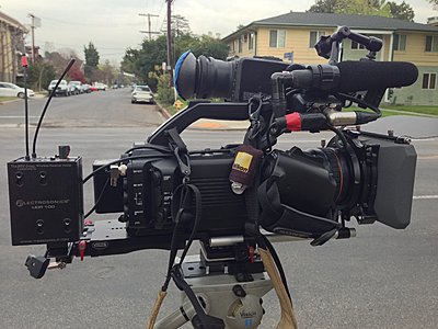

I was an ex-3 user for years and upgraded to pmw-300 I really like it and have a Vocas rig for it that is great. Battery solutions are coming soon. I also shoot with a GH2 and will be getting a GH4, one camera cant do it all.

Also Im testing a Beta Test version of a Switronix battery with a DTAp that is Awesome, no need to plug in and gives u a minutes meter in your viewfinder So Far So Great

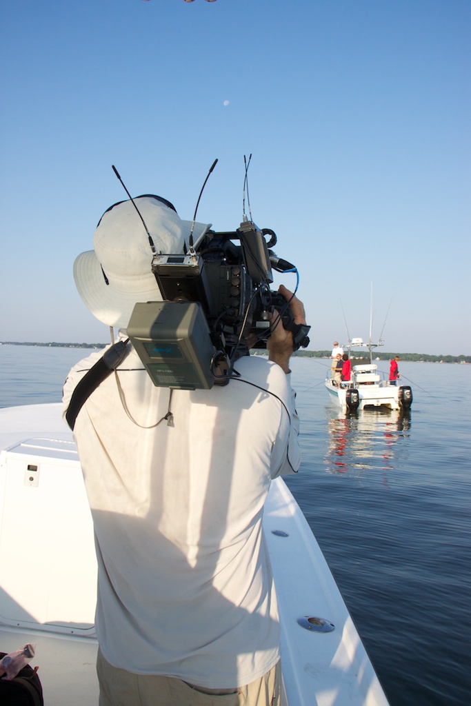

There is a V-Lock adapter, that is the only way I have been powering my PMW-300 since May, balances well with the Canon KH 10ex3.6 lens. The problem is Sony limits the voltage shut off/alarm on non-Sony batteries. So I only get 50% of my battery usage and then I have to switch. And using Switronix 130W/h batteries that is too bad.
I use the DM Accessories shoulder brace/heavily modified, see picture. And their V-Lock battery mount. My setup is a great eng setup. But I do have to switch to go on sticks. But most of my days are 100% on the shoulder.
Now there is one thing you can do and I have been trying to tweak it, you can adjust the voltage minimum input on the V-Lock plate. Just contact DM and he is happy to help walk you though it, it is very easy.
Couple of not so good pics showing the camera setup.
PMW-300 owners - opinions needed-_mg_3210.jpg   PMW-300 owners - opinions needed-_mg_3273.jpg
