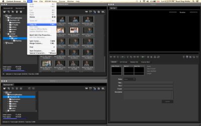

I think I must be just to used to using XDCAM Transfer - I can't for the life of me figure out how to get footage from my SxS cards to a portable hard drive to send back to the studio for the post team using Content Browser. I don't see anything obvious (to me) in Export, but I think that's because I'm looking for something with "MOV" in it.
Could someone give a simpleton like me a short step-by-step from the part where I'm viewing the SxS card in Content Browser?
Anthony
Anthony Nalli is offline   Reply With Quote
Old May 18th, 2014, 09:32 PM   #15
Join Date: Sep 2002
Posts: 4,088
Re: xdcam transfer
Navigate to the directory with the media on your card, click Edit => Copy All and follow the dialog boxes.
