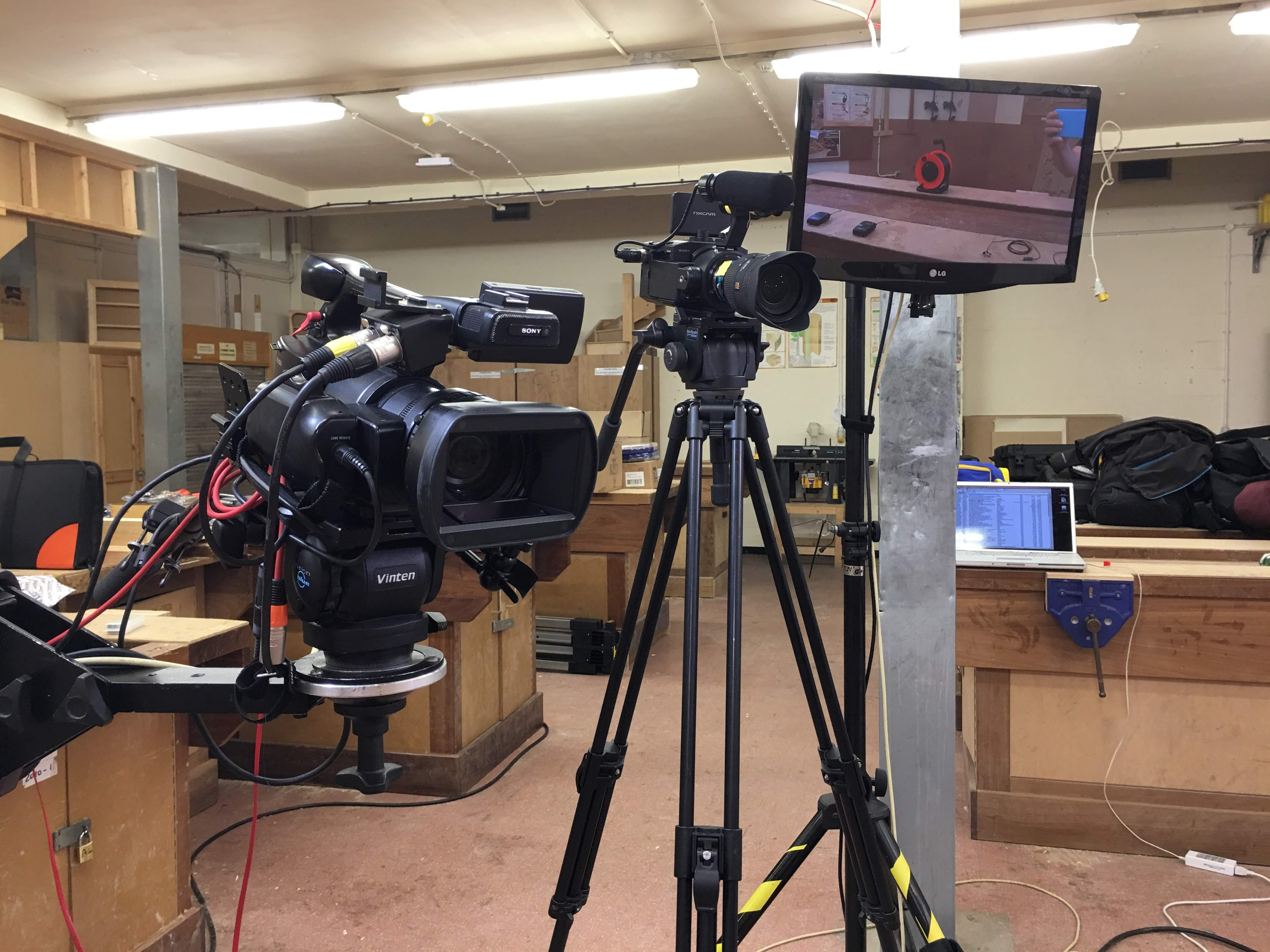

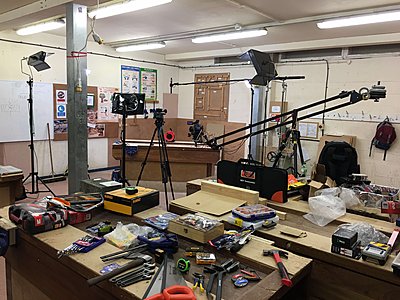

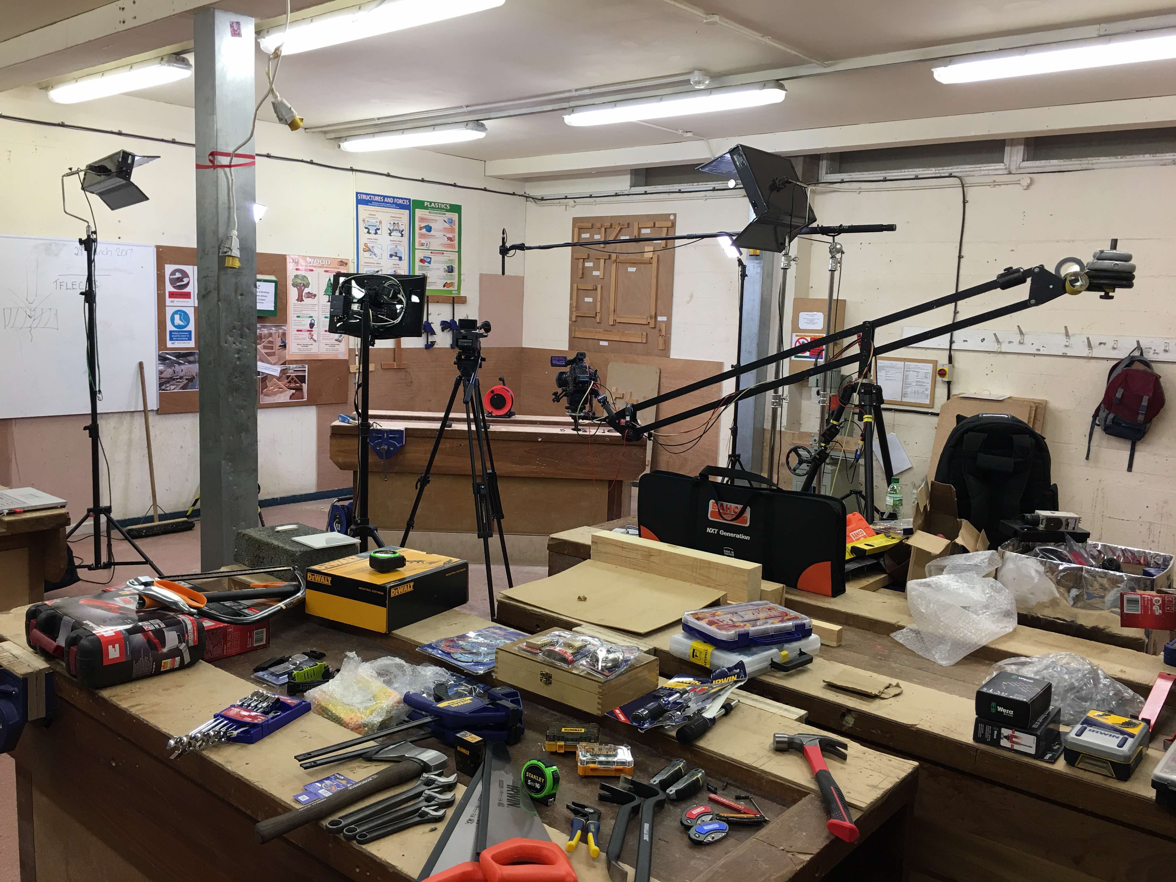

I would really like to find a modern 4k replacement for the EX1 I bought in Jan 2009. The camera has been such a workhorse when I think about it, and it's still in great condition.
I just filmed some theatre shows with my EX1 (left), an EX1R (right) and my JVC LS300 (wide and in 4k so I could zoom in post). With a simple talkback system between me and the EX1R operator it worked out nicely:
I've just spent three days shooting my regular tool demo videos with the EX1 on my jib. It certainly is heavy, and while the lens does bump a little on low speed zoom-outs I can work around it. I shoot on 32GB SD cards with the latest firmware and have no problems. The main screen backlight is starting to fade a little it seems, perhaps I'm just used to better screen on other cameras. Of course I'll never sell the camera as it's worth so little, which is both a good and bad thing I suppose!
