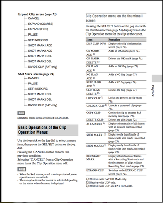

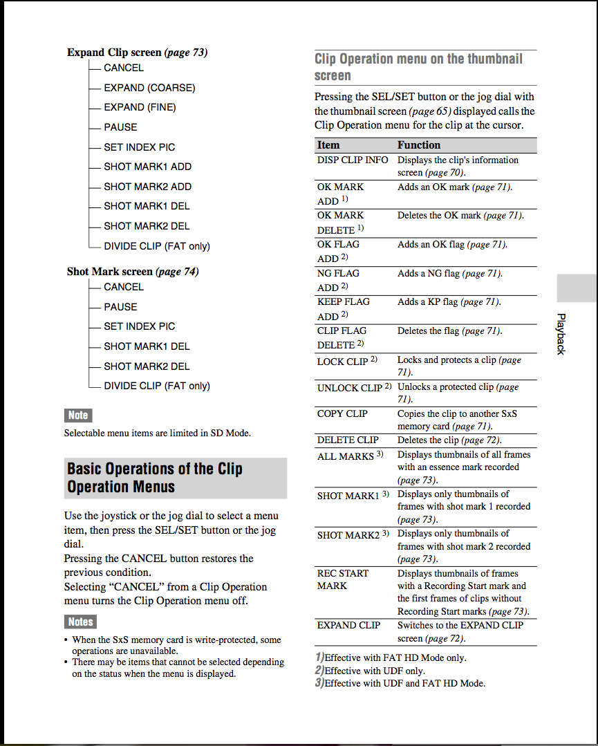

Or, if you just finished the shot and decided it was audio only and were stupid enough to leave your Time Machine in the car thus prohibiting you traveling back in time, Check out the Clip Operations Menu "OK Mark". Maybe you can assign it to a button. You could on the predecessor EX1R. YMMV

On the remote for the camera there is a 'shotmark' buttons #1 and #2 that can be used whilst the camera is recording, primarily to make easy identification of good takes.
You could always adapt the functionality for your specific purpose.
