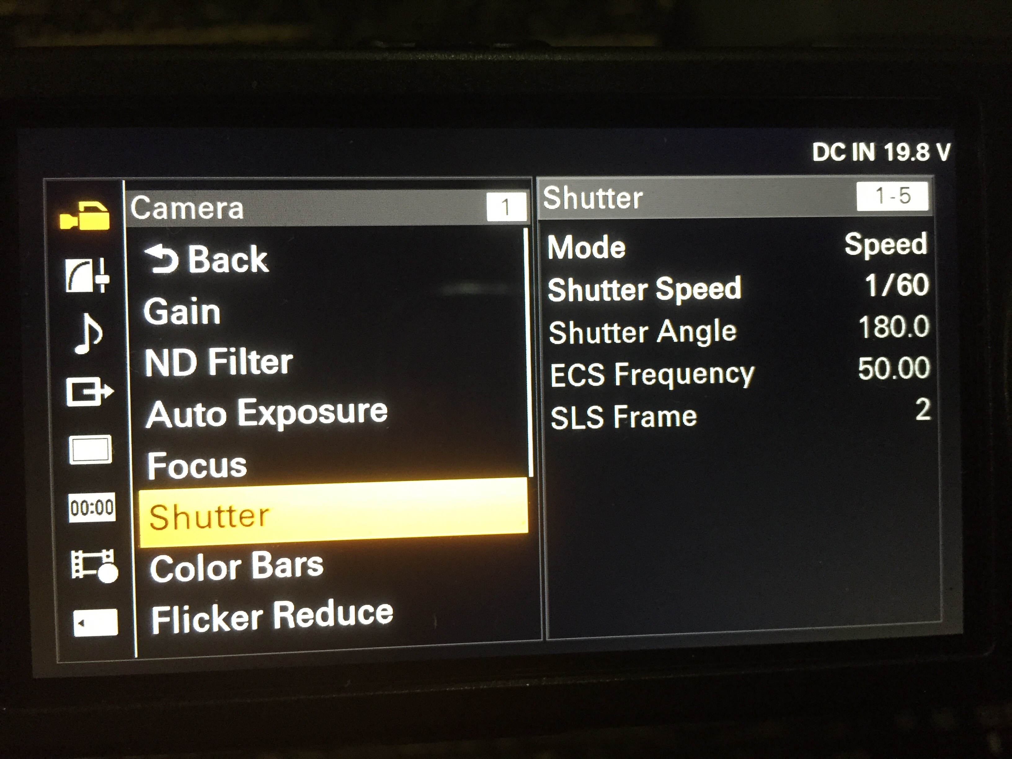

This all I ses
change the  shutter to 1/50-image.jpg

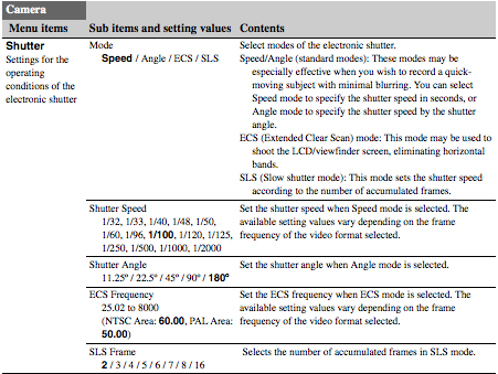

A lot of cameras these days in 60Hz setting have a minimum shutter speed of 60th unless in slow shutter mode. If the camera is set for 50Hz shooting it will be a 50th. Plus I seem to recall that in the 160/180 manual under the 'Camera' menu under the menu item 'Auto Exposure' the 'Auto Shutter' setting must be set to OFF. Worth checking.
Also take note of the "depending on the frame frequency" comment on page #66 of the manual, at least that's the page here that says the following:
Set the shutter speed when Speed mode is selected. The
available setting values vary depending on the frame
frequency of the video format selected.
Shutter Speed
1/32, 1/33, 1/40, 1/48, 1/50,
1/60, 1/96, 1/100, 1/120, 1/125,
1/250, 1/500, 1/1000, 1/2000
Basically what we used to do was shoot 60th second on PAL cameras when in the States or if shooting here for US or Japanese clients in NTSC we used to shoot at 100th as that was twice the mains frequency. Either way you minimize the 10Hz flicker off-set.
This advice could be wrong but as I no longer have a 160 or 180 to physically check with I am just relying on the old grey matter and the PDF manual.

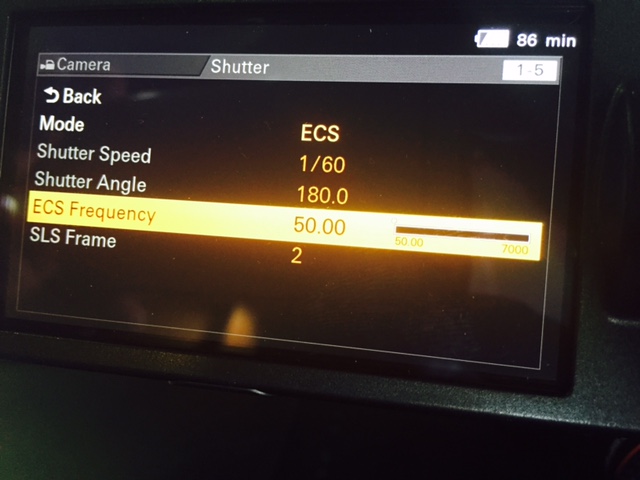

I had a look, at the Auto Exposure, and that is set to off, the other option is not a option as I am in a low light setting some times and 1/100 is to dark. I did see this option, but I am not sure if it will work, ECS Mode, See pic. I don't know enough, Its just a test and trial with this camera as i can't find a instructional Video for all the setting in the menu. Thanks for you help.
