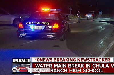

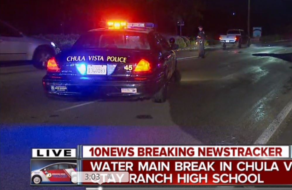

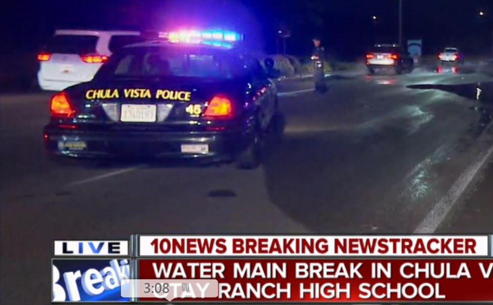

Even MORE lens issues, definitely looks like a backfocus problem. I was shooting a live shot this morning, and noticed in the viewfinder that as I zoomed in even a little bit from full wide angle, the picture was going blurry. When I hit my full telephoto, the objects I had selected focus with were in focus. I swear it seemed like the backfocus was shifting and trying to keep up, but lagging behind, my zoom! Think of it like how a camcorder AF hunts for focus. Now imagine the X180 being on manual hard stop focus, and as you zoom in, the backfocus is hunting like a home video camera AF, adjusting as you zoom. I took a couple of screen grabs of my live shot. It is VERY OBVIOUS, as you can see the letters and numbers on the license plate literally SNAP out of focus. This was a slow zoom in, and observed in the VF, so this is not an artifact of the live signal transmission. I was actually focused on a point far down the street. As soon as I can get a hold of Sony, I am going to get them to fix this damn camera, or I will make it my mission to cost them as many X180 sales as possible for designing and selling a defectively designed product and taking peoples money for it.
