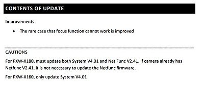

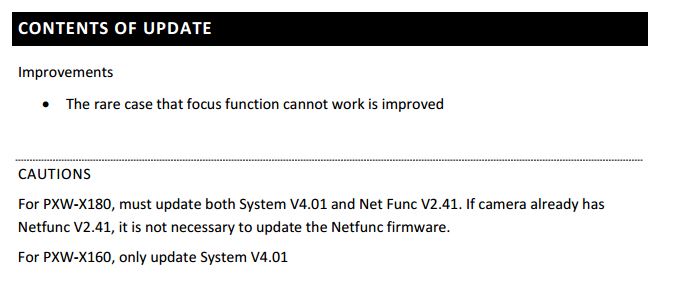

Well, finally, a YEAR LATER, Sony has issued a firmware revision specifically to fix this lens issue. This would have been nice before they sent me a brand new camera which I sold new in box for only $3000, taking quite a loss from my original purchase price.
Ugh...
