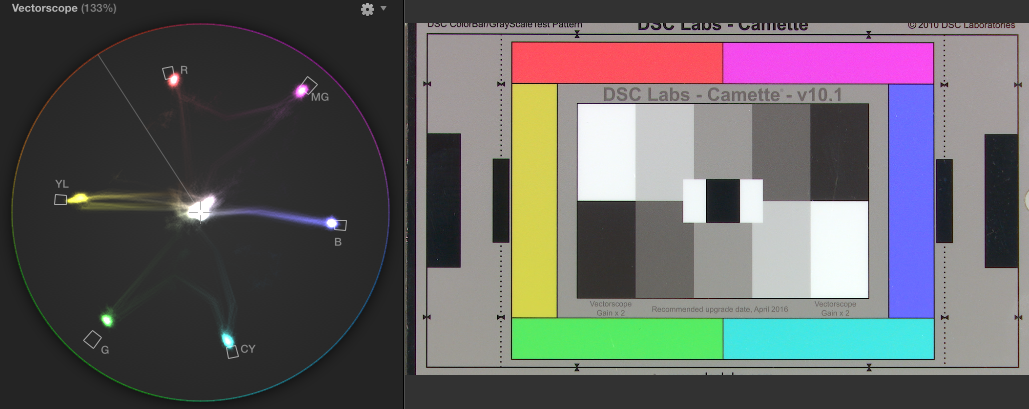

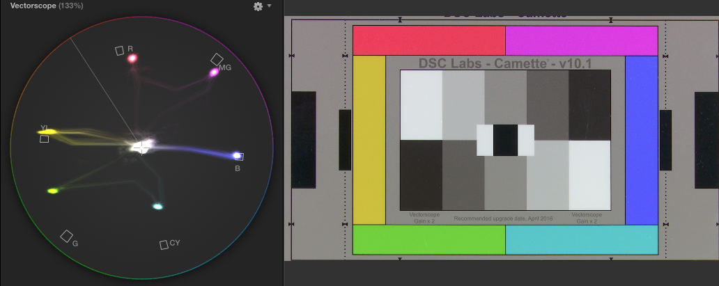

Sure Rob, here are my official Paul Anderegg ENG Night Profile settings, calibrated at 3200k using dual Lowel Omni tungsten light source. :)
BLACK On
Master Black: -1
R Black: +4
B Black: +3
MATRIX On
Adaptive Matrix On
Preset Matrix On 2:ITU709
User Matrix On
Level 0
Phase: -8
User Matrix G-B: -13
User Matrix B-G: -35
MULTI MATRIX On
B: +4/+13
MG-: +16/+20
R: 0/-14
YL: -21/+4
YL+: -10/+10
G-: -40/+55
CY: +20/+71
Those are the settings needed to get the ITU709 preset colors into the boxes so to speak. These settings are only valid on Preset 2 ITU709, any other selection will result in non accurate calibration. The black settings were needed to get the dot in the center of the scope with the lens cover closed. Auto Black Balance will reset those figures, and wanted to push towards a green hue in the blacks, especially evident when gained up. With a black level of -1, the negative light black level still hovers a bit above 0IRE on the waveform. Will post some DSC chart frame grabs in a separate future post.
Let me know what you think of these Rob.
Paul

Here are the stock and after calibration vectorscope images. The one that is really bad is obviously stock. The calibrated green vector was 5 less than the above calibration data, I was afraid of green shift so I cut back the green a bit. The demo YouTube clip is using the figures listed above, with increased green to match the other colors.
