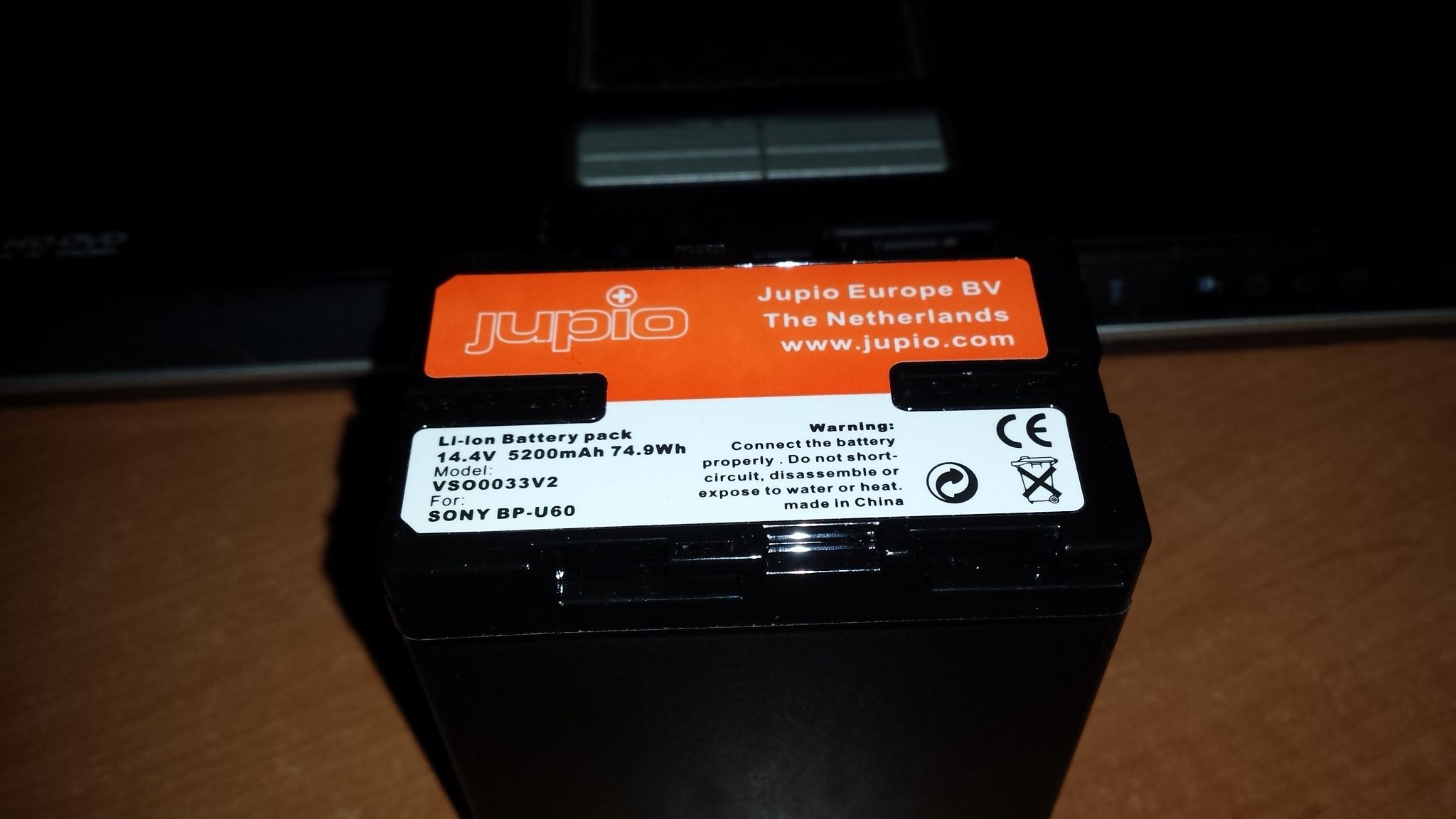

No experience here with the Dynacore Dave. There are a number of posts around the web and here where some folks have had problems on some Sony cams with non Sony BPU series batteries.
Videocraft spent a fair amount of time checking a variety of brands of BPU type batteries as customers wanted something cheaper that a) wasn't going to void warranty and b) and that wasn't going to reset the camera back to the region / zone menu as was the case with FS5's and FS7's. I believe the latest Swit batteries are okay but I know some of the earlier ones did have issues as mentioned on previous DVInfo posts..
After Videocraft's pretty extensive hunt and testing of batteries that communicated correctly with the Sony voltage coder/decoder chips in the cameras they ended up selling, and felt safe to do so, the Jupio series of BPU batteries from the Netherlands. 74.9Wh, so like the Dynacore virtually 35% higher rating than the original Sony BP-U60s. Made in China like everything else but built to the Netherlands spec.
Jupio Batteries & Chargers | Power to the World
Put the hard word on Videocraft or even Dragon Image and you should be able to pick them up for around AU$225.00 each. I see Globalmediapro want something like AU44.00 shipping for one and AU$60.00 for two. AU$202.00 plus $44.00 for one works out more than the Jupio units. No D-Tap on the Jupio units though. Local warranty and support was the most important thing for me.
I and a few shooters I know are using them on. EX3, PMW-300, FS5 and FS7 with no problems so far. I've had mine for six months now on the FS7 and touch wood all good as they say.
If you go with the Dynacore batteries keep us posted. Would be very interested to see if there are other batteries that will do the job. D-Tap and USB would be useful features.
