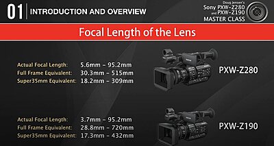

Originally Posted by Doug Jensen View Post
Compared to a camera with a full-frame sensor, the Z280 has the equivalent of a 30mm to 515mm f/1.9 lens. You will never find an such a lens in the real world. And if you did, it would be so massive you couldn't shoot with it, and it would cost so much that you couldn't afford it.
Its worth noting that the Z280 lens also has auto-focus and servo zoom.
Now I have the sony FX6 and A7IV I was thinking about a telelens. I thought I needed a 500mm full frame lens to match the reach of the Z280 (fully zoomed in)
But I watched your master class and that was confusing for me. See attached image.
18.2mm - 309mm super 35mm equivalent?
Christopher shot with a tamron 18-300 mm F/3.5-6.3 (APSC) lens so this lens would have the same reach as the Z280? (of course in crop mode)
I'm just trying to understand this correctly.

Hi Tom, I'd be more than happy to shed some light but I don't think I understand your question.
The FX6 is a full-frame camera, therefore it requires a telephoto lens that is approximately 500mm to match the reach of the Z280.
I don't know anything about the Tamron 18-300 mm F/3.5-6.3 (APSC) lens, but if it is an APSC lens (also known as Super35) it is an inappropriate lens for the FX6 unless you intend on shooting only in HD. There is no 4K crop mode so the FX6 is always a FF camea when shooting 4K, and therefore requires a FF lens -- the Tarmron is not a FF lens.

hi Doug,
515mm full frame equivalent and 309mm super 35mm equivalent for telephoto on Z280.
When I would buy a 500mm full frame lens (for example the tamron 150-500mm) then you can have it in crop mode -> 750mm in super35. (yes, Super35mm on FX6 is always HD)
So It's strange to me that the super35equivalent in your "slide" is shorter than the full frame equivalent.
I thought it would the opposite.

Here's another way of saying it, all four of these combinations would have a similar field of view:
1) Z280 with stock lens zoomed to 91mm
2) A full-frame camera with a 515mm lens
3) A full-frame camera running in Super35 crop mode with a 309mm lens
4) A Super35mm camera with a 309mm lens
If you put all four of those combinations on tripods next to each other, they would result in a similar field of view on each one.

thx Doug!
2 = 515mm full frame lens
3 and 4 are both a apsc (super 35mm) 309mm lens
I could also buy a 400mm full frame lens and use that in crop mode so I would have a 600mm reach.
(but only in HD mode on fx6)
that's right?

Tom, you now own a couple of FF cameras so don't even think about S35/APSC lenses anymore. Waste of money.
If you need a telephoto lens, I highly recommend the FF Sony 200-600mm. It is a fantastic lens that ought to cost a lot more for what it can do. It is literally on my FX6 99.9% of the time.
