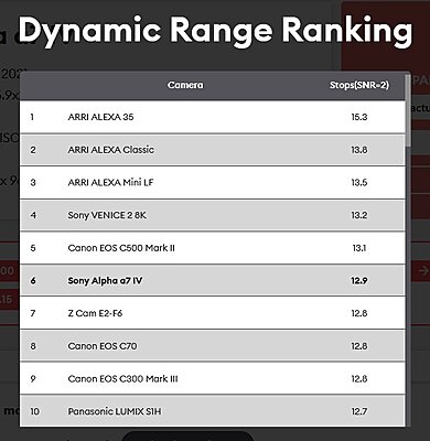

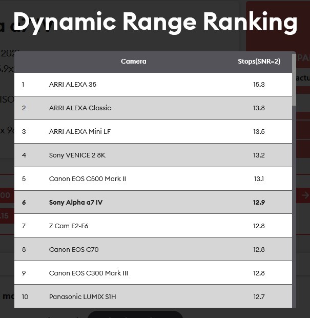

Yes, in crop mode. In crop the A7iv is still downsampling from 4.6k unlike the 12MP FF sensors from Sony which as you say do not have crop mode in 4K. So the A7iv is delivering a very crisp very quiet image. And yes, again, the Tamron 18-300mm is an APSC lens, (27-450mm FF equivalent) . Which suits me as it also works on my two FS7s which are still getting plenty of work for in both corporate and broadcast. So APSC glass fits the bill for me. Generally, the APSC glass is also smaller and lighter, and often cheaper.
I mainly got the A7iv as a hybrid for stills and occasional video. The truth of the matter is, I now find myself using the A7iv far more than I thought I would on video. In combo with the 18-300 it's proven its self. To the degree that I'm going to drop the $$$s on the Tamron 17-70mm F/2.8 APSC lens (FF equivalent 25.5-105) as it can do dual-purpose work on both the FS7s and the A7iv.
When I saw the promo video for the A7iv last year I felt it might fit the hybrid bill. Since I got it, it has shot sideline in football and the pits in motor sport and It's shot live stage entertainment, corporate and doco material. I haven't regretted getting it for one minute. For corporate work where PC screens with off-frequency scan rates need filming and a fully variable shutter in 0.1 steps is required, the A7iv is the go-to camera. I can't do that with the FX6. For doco type interviews with FF lenses it can deliver stunning footage because of it's dynamic range and very good AF.
You hear a lot of people dump on the A7iv because it does display more rolling shutter in full frame than an A7siii. Most of this comes from keyboard warriors not users. That doesn't worry me in my real life shooting. In crop mode it has a better rolling shutter at 13ms than the good old FS7 and for me that has never been an issue for motor sport which I have shot a ton of. A fantastic rolling shutter is something I only require occasionally. Great dynamic range? I want that every time I pick up a camera. To me, dynamic range is one of the most powerful tools in our hands to capture what we see.
A camera that can cover the range of material seen in these videos with decent results is beyond anything I'm shooting these days, so plenty good enough for my requirements.
Chris Young
CineD latest camera dynamic range chart and the Sony "Shot on A7iv" release video, along with Jacques Crafford's nice piece shot on the A7iv. This last one was the one that convinced me I could work with this small A7iv camera.
